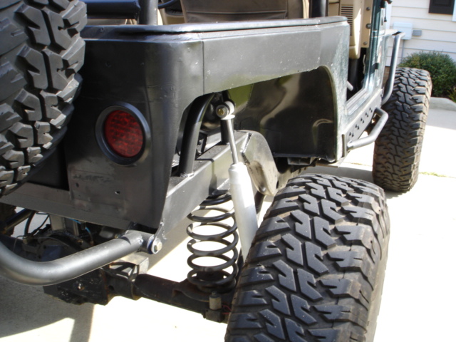

I am comp cutting the rear of my YJ and I want to have your opinion on the types of cuts you like. Post some pics so I can see what you are talking about. I do not have a cage yet, but eventually I will.

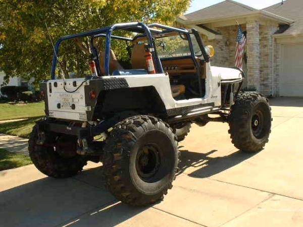

I like pretty much anything that looks nice and clean. Here's some pics, I've got more too. Do you want to dovetail it and all that other stuff too?
I do not want to dovetail it, I just want to comp cut it since I bought the YJ2XJ kit. Which YJ was yours? I am having trouble figuring out the geometry with the cut. I don't want to screw it up. I am trying to stay far enough from my LED's.

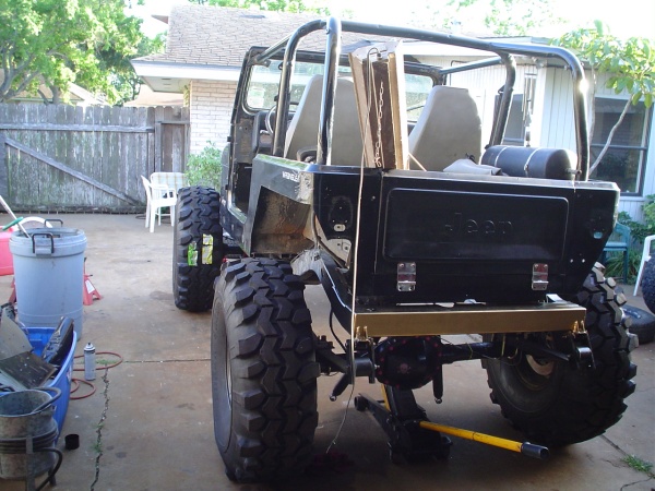

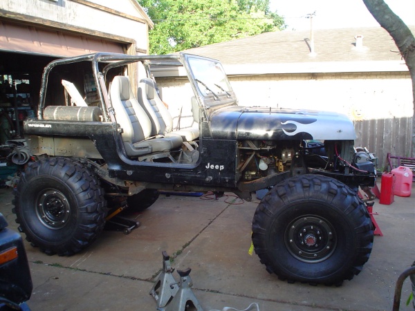

Oh, then ignore the dovetailed parts of the second group of pics.
None of them are mine. I never got around to doing it to my Jeep. A few of those have LED's too, so hopefully that gives you a few ideas.
I really like the cut on the 1st pic. Have anymore of it? It doesn't seem like he followed the first half of the semicircle.
You mean the black one with the goodyear MTR's and the fuel cell? nope, those are the only pics I could find of it. He definatly should have smoothed that out a little more though.
Get the axle under it, and drop a plumb bob from the fender down to the center of the axle hub. That is the centerline of your new wheel opening if you're not planning on doing the full cut. After laying that out, it will be apparent where you need to cut after a couple of measurements. Use cardboard templates to find the look you want BEFORE you start hacking metal.

The black jeep with MT/Rs also has the rear of the tub narrowed, notice how the sides of the fenders kick in as they go towards the rear.

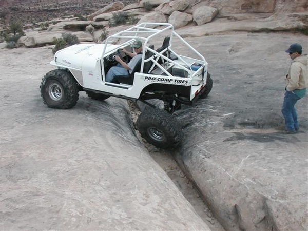

Looks like the jeep with the 'ProComp Tires' sticker put the wrong sticker on his jeep ;)
I like the first white pic, not the black one. That is dovetailing on the black jeep.
I like the look of a comp cut, but there are so many ways to do it. And you only get one shot at it. I think I will try to get it to look like this
Unfortunaltely, I already have round taillights. :evil:

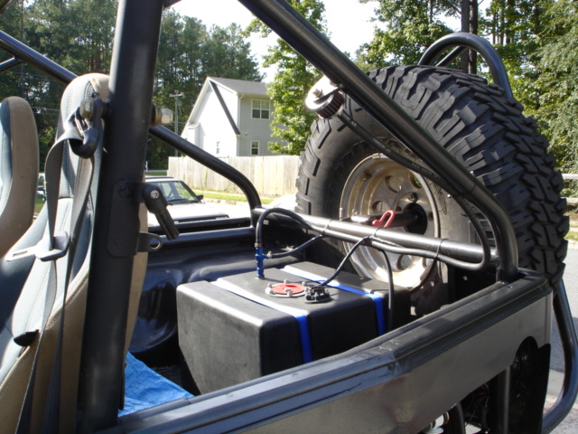

As far as the rear body mounts, they will have to be removed for the xj kit. I am somehow going to have to fab some new ones. I am putting my gas tank into the cargo area and bolting it down. As far as fuel lines, I am going to drill holes in the tub to do run them to the motor.
Both of them (the white and black jeep) in the second group of pitures are dovetailed (narrowed in the rear).
Haha, I didn't even notice that about the tires though, that's pretty funny :lol: .
I like that look on that Bluetorch Fabworks Jeep though Bryan! The very first white Jeep and the very first black jeep pictures that I posted are the same thing, which is why I posted them (I like the look!!).
On that picture you posted though Bryan, see where his fuel door used to be....I would take some metal and weld in a piece there so that square opening will be gone.
That would give it a real clean look and wouldn't be hard to do if you have a welder and a grinder and some paint.

The problem is that I cannot make the rear look exactly like that with my round LED's. Unless I fill in all the holes with metal and buy some lights like that, but I love that look.

I'd love to do such a mod... It requires fuel system modifications though. I can't sacrifice cargo area
