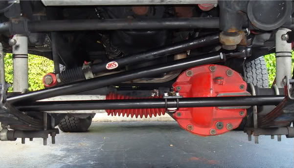

You can get it rewelded, I would think, OR install an aftermarket damper with the clamp-on type brackets if there's room. I put one of those on my Dodge truck and one on my M38 - they have both been fine. Best of luck - John
If the axel side broke, I would try to reweld; if it is the drag-link side that broke, I would use a couple of U-bolts and make a plate in the same way that aftermarket steering components use (mine looks like this).
