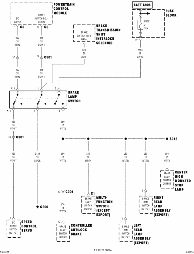

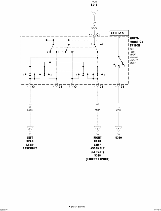

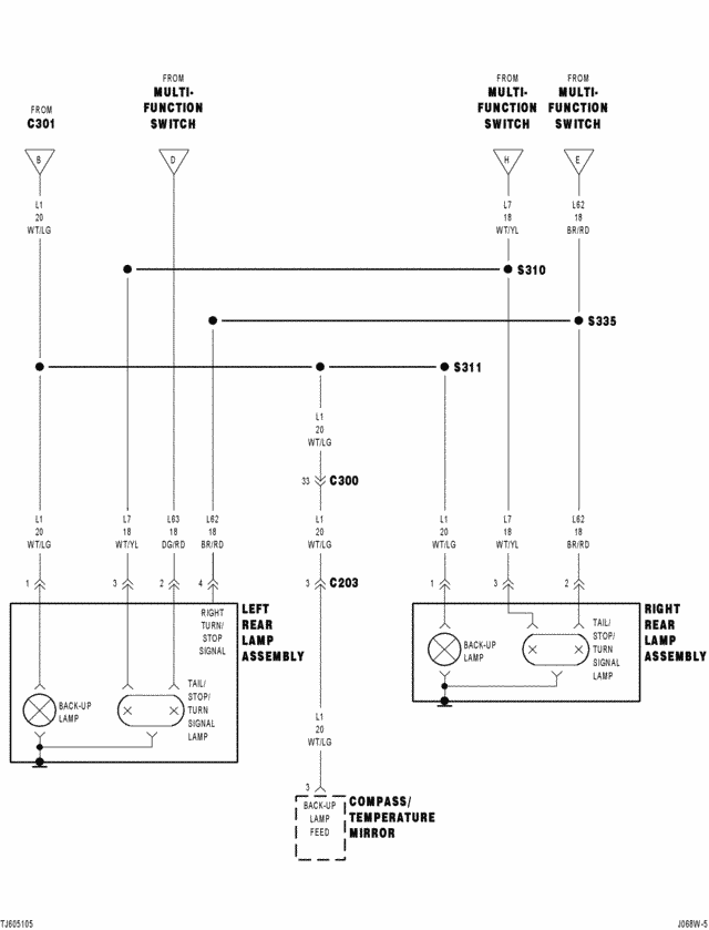

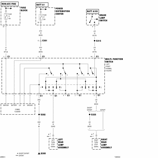

Here's the pinout's on the Reverse lamp switch and brake switch. I also found the schematic diagrams related to what you need as reference. I hope this helps.
Note: Automatic transmission uses the TRS(trans. Range sensor) to turn on the backup lamps.
BACKUP LAMP SWITCH (M/T) - BLACK 2 WAY
CAVCIRCUITFUNCTION1F102 20PK/DBFUSED IGNITION SWITCH OUTPUT (RUN)2L1 20WT/LGBACK-UP LAMP FEED
LEFT REAR LAMP ASSEMBLY - 4 WAY
CAVCIRCUITFUNCTION1L1 20WT/LG (EXCEPT EXPORT)BACKUP LAMP FEED1L63 18DG/RD (EXPORT)LEFT TURN/STOP SIGNAL2L63 18DG/RD (EXCEPT EXPORT)LEFT TURN/STOP SIGNAL2L1 20WT/LG (EXPORT)BACKUP LAMP FEED3L7 18WT/YL (EXCEPT EXPORT)HEADLAMP SWITCH OUTPUT3L50 18WT/TN (EXPORT)BRAKE LAMP SWITCH OUTPUT4L62 18BR/RD (EXCEPT EXPORT)RIGHT TURN/STOP SIGNAL4L7 18WT/YL (EXPORT)HEADLAMP SWITCH OUTPUT
