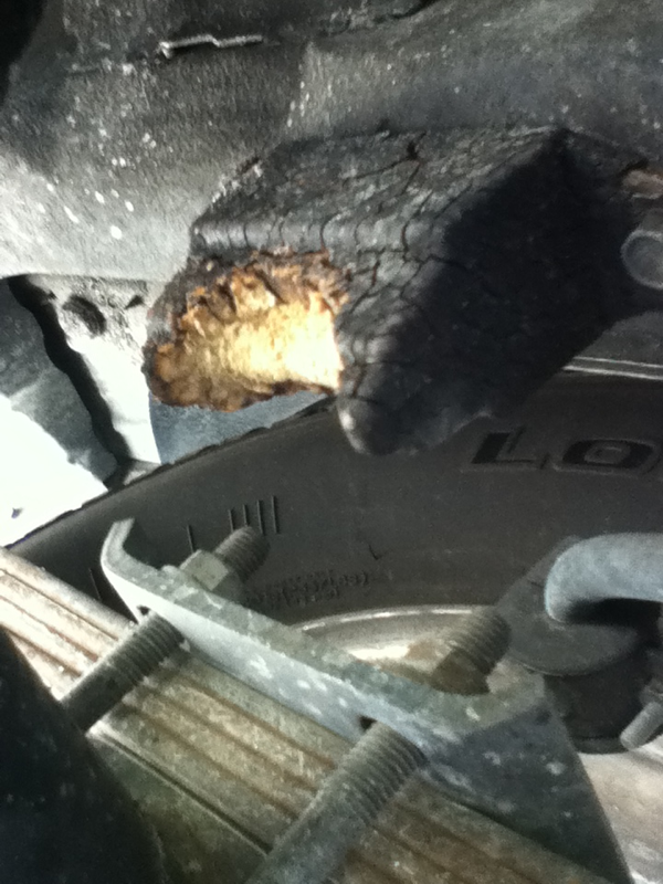

im not running a lift right now but my bump stops look like poopie
maybe thi is the problem... then again i only get 1.5" between the top of the tire and the inside of the fender
Wow those have been hit a few times. Your rear springs are probably sagged out buy the looks of those bump stops they have been well used.

yeah lol i like mud and dirt... alot, and so does my jeep, well i guess ill have to take a goo look at it tomorrow, maybe ill load it down really good and see if it touches anywhere other then the fender
Ya. My jeep likes it to. I would suspect its Tired rear springs. The stock springs don't hold up super well.

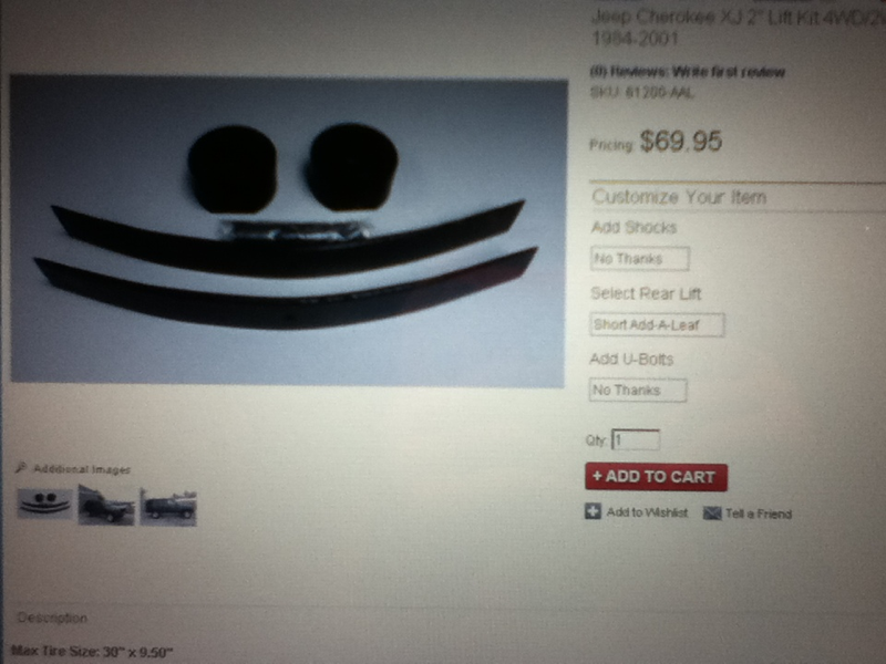

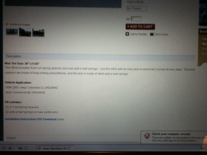

i found a dirt cheap lift, its a fatbobs garage 2" lift kit for $69.95
it includes
(2) 2" polyurethane coil spring spacers
and
(2) add-a-leaf springs w/new center pins
do you think it would work well and is it worth it?

For 70 bucks can't go wrong. Probably won't find just the add a leaf for that much

it says the add a leaf will lift it 2" in the back, does it really do that much? the leaf looks less than a cm thick... i probibly sound stupid but i dont know much about this stuff

Bad idea like jester said you need to either replace your stock leafs for oem spec leafs or get a lift with a full pack an AAL will just last you a short time and then you will be at the same place you started you might look in to ******* packs if you don't want new springs it might help for a longer. What distance are you getting from the center of your rim to the bottom of your fender flair
Add a leaf is about 2" in the back but if your rear springs are sagged it probably won't be tgat high. The add a leaf is arched steeper pushing the spring pack higher and has a higher spring rate.
