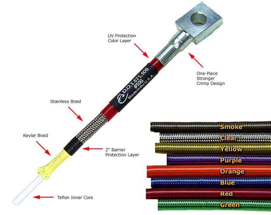

Better to bite the bullet and put on stainless steel lines that will stand up to the abuse. is 80-124$ worth the peace of mind of stopping at the edge of the cliff?

Also, aren't most stainless steel brake lines not DOT approved?

If you are talking about the front, you can also route your existing lines inside the frame (at least you can on a YJ; not sure on a TJ) and this will give you a couple more inches. if it is the rear (and I think this is what you are talking about) I would go SS or limiting strap (or both).

i have those on... Have not had any issues. I am actually happy I got them, because the crappy mechanic I was using left the hardline extensions when i got these installed, and the sway bar was rubbing on the driver side. If i would have had regular lines, they would have teared most likely, but the SS held up just fine (only the plastic cover was teared). Needless to say, i fixed this problem already!
YJ lines are just fine.
They are bent slightly different at the caliper end, but it's no problem to bend that hard line end slightly (carefully) to work.
Stainless lines are also good, and may or may not be cheaper, depending on where you buy.
Some are DOT approved, while some are not.
Of course, I'd go with the DOT versions.
