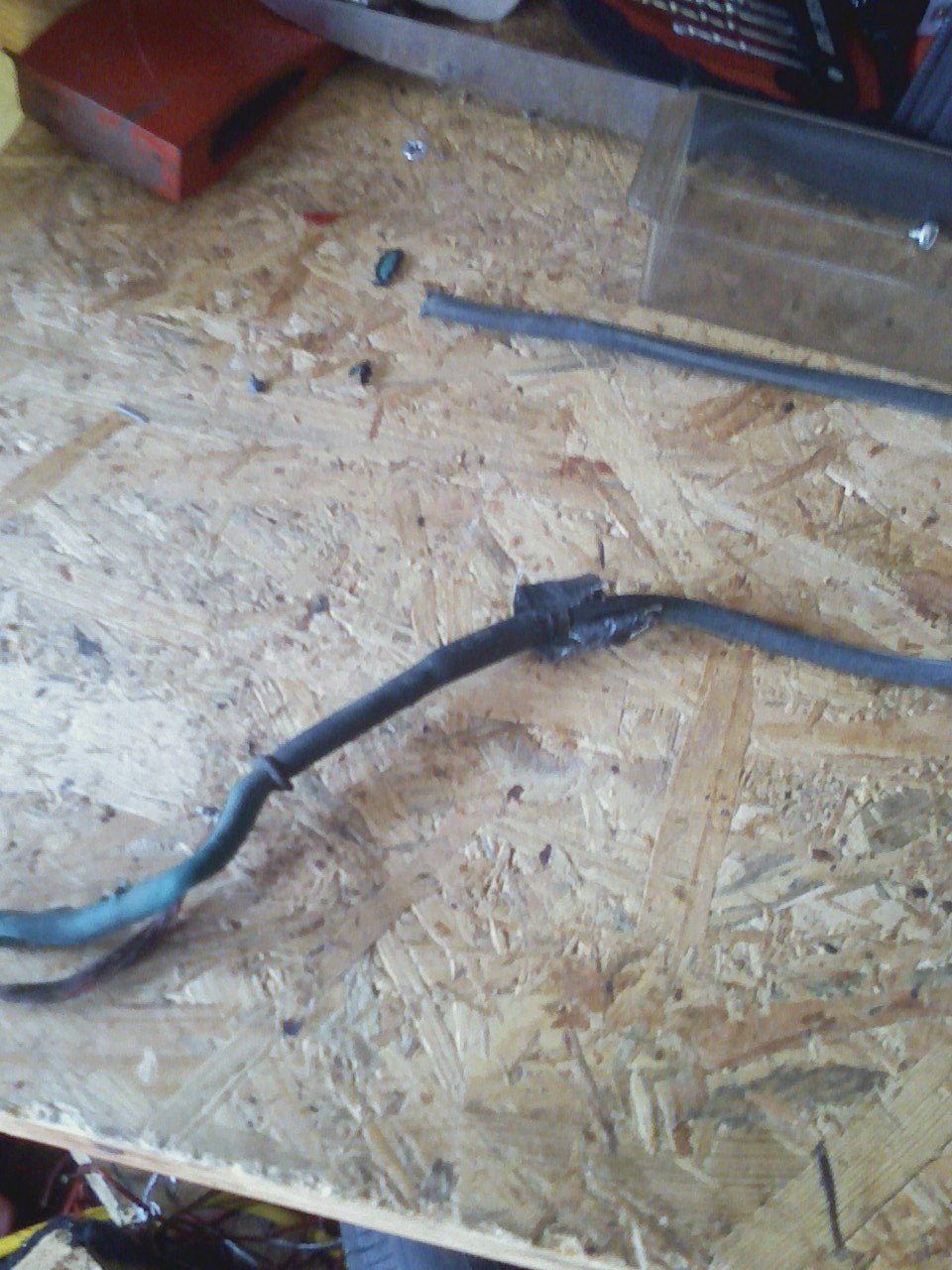

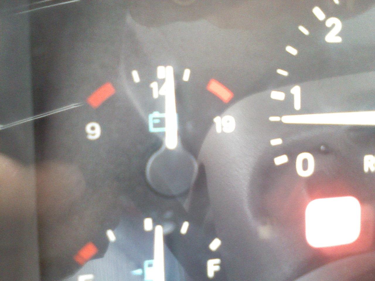

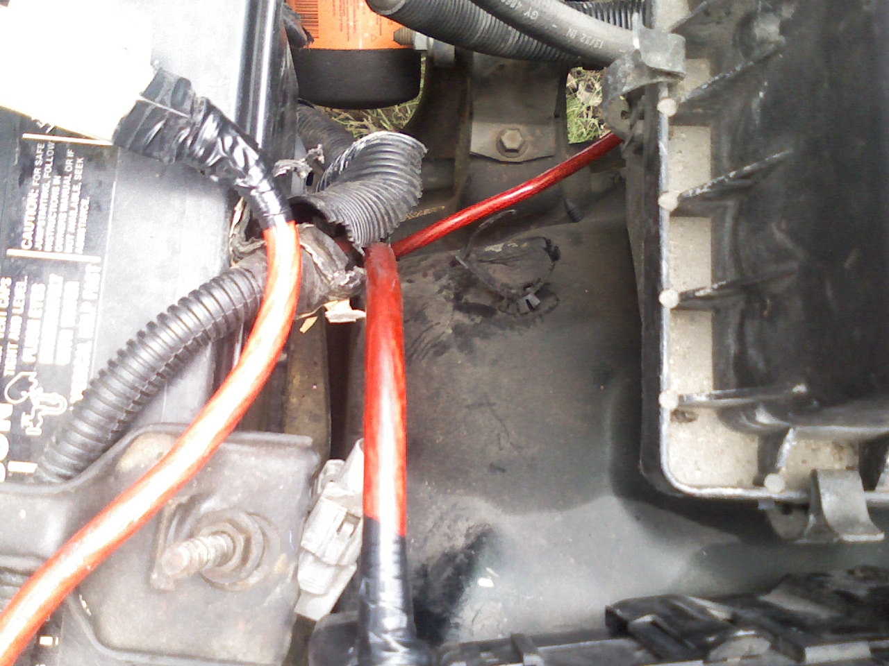

I found out why my alt. wasn't charging as good, the wire going from the fuse box to the alt. was just all ate up. So here's some pics as to what I've done,first pic is the old wire, second new wire in place, and 3rd is my gauge a little over 14, it used to be under 14.
