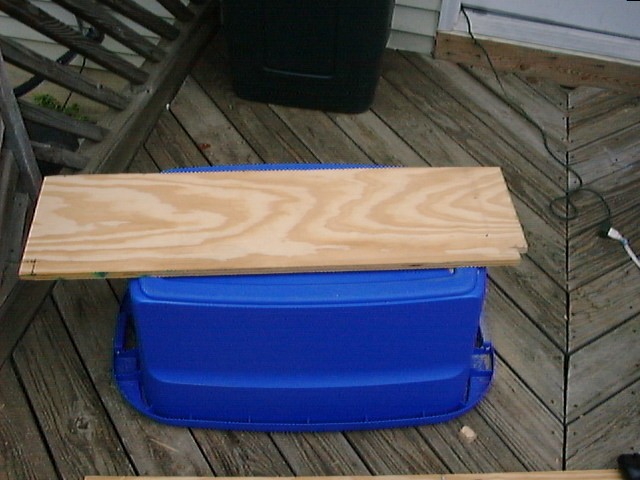

Step 1
I bought a piece of 3/4 inch plywood from Sears Hardware ($7)

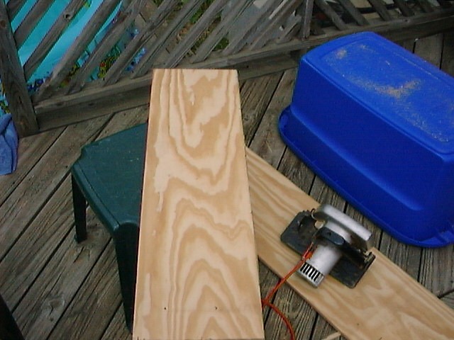

Step 3
Now you need to cut out notches to make room for the tailgate. Cut off a a 3" square on both corners of one side

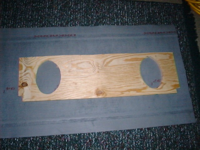

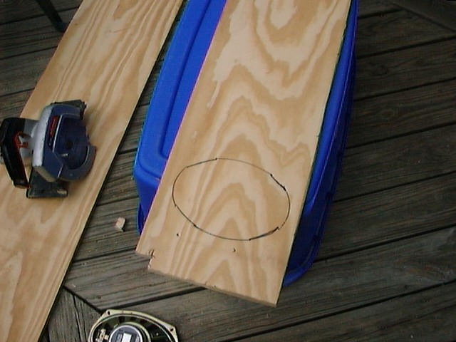

Step 4
If you want, you can cut speaker holes.

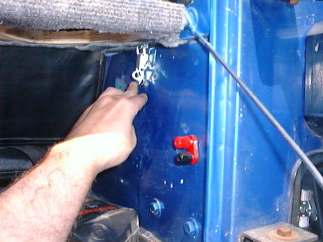

Step 6
Put latches on (I used the same type that come on foot chests). This allows you to snap your deck in and out, and will secure your valuables

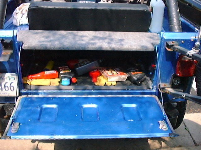

Step 6
Now you can hide your Junk!
