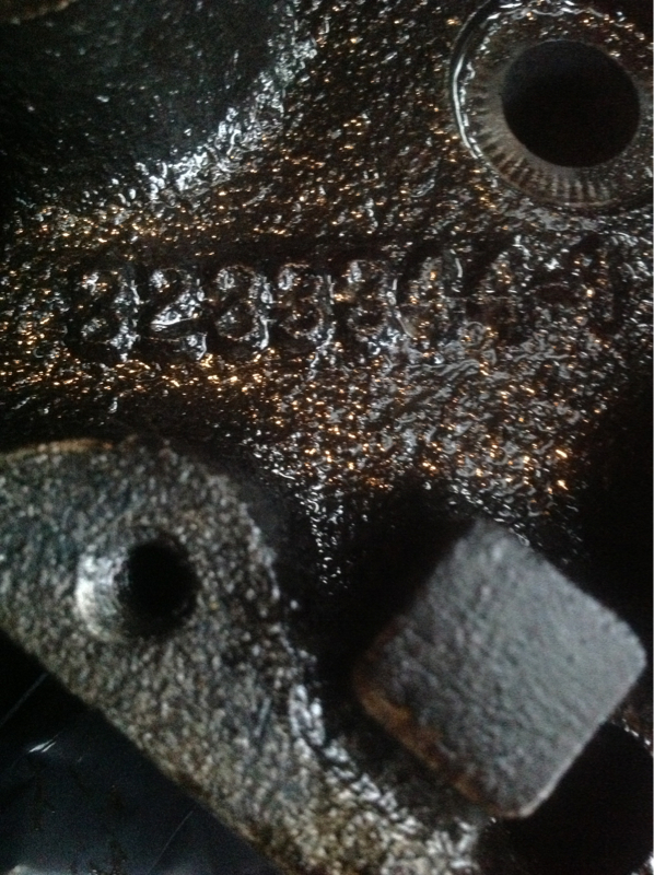

It's a amc engine, 3195528 it the number on it. I think it was out of a javelin but I realy don't know, trying to remeasure the bore, my brother did it the first time, I'm at college during the week. Me and him i guess own it together, I don't know what heads are on it right now, haven't actualy seen them off. Hopefully going to know a lot more come Friday. The pistons say .030 over but that could be .030 over about anything. I'm going to get him to remeasure tonight and I think the original displacement is by the motor mounts on the amc v8s he's going to try to find that too. How do I know what heads I have, they need work already I know though
you dont need to remove the heads to ID them. Just take off the valve cover and there will be a ID number just like the block (exampl: mine are 3890462) then google the rod lentgh for them. the 30 over pistons wont nessisarily mean longer rod, I believe the rods just dictate how far the valve opens. larger pistons mean a overbore (larger displacement engine). ur engne size is now probably around 331CI now.

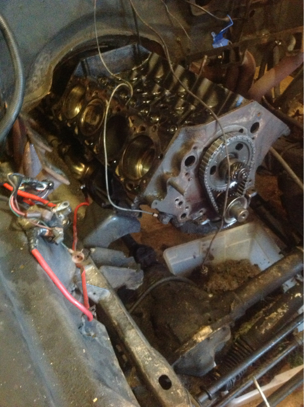

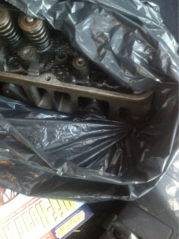

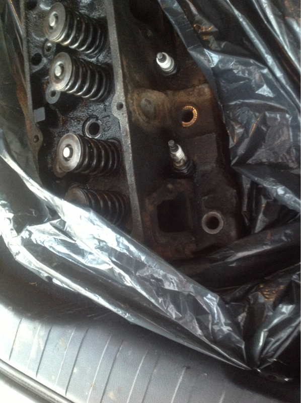

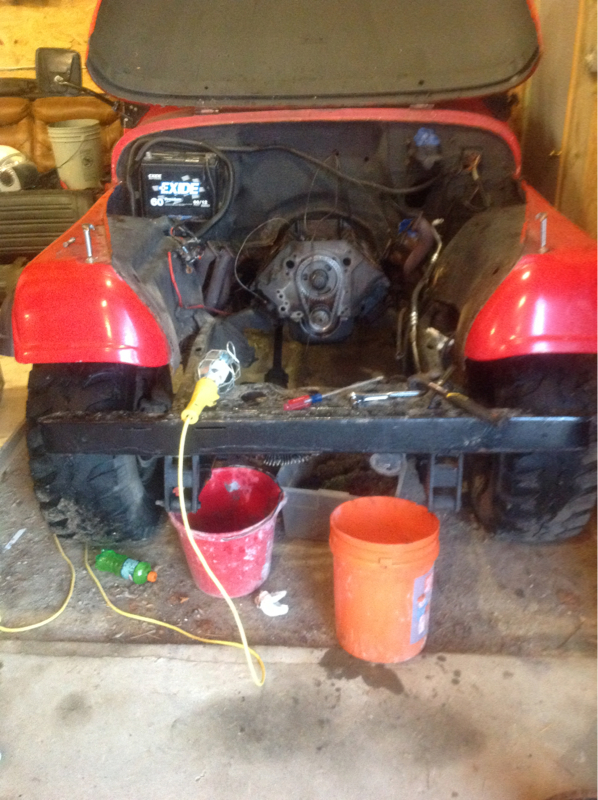

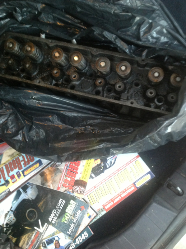

Home, got my "new" steering column ready to be mocked up. Looked at the casting of the block, says 360, measured the bore, 4.108 so they are .030 over 360 making it a 365 I believe. Got pics of the heads and the block in the jeep, little rough looking.

I have no idea about the ajustable rods, sorry, I dont know enough about rebuilding. I dont know what you mean about shaft or stud mounted rockers, sorry. can you post a pic. If you havent cleaned up those heads, they look better than a lot I have seen. most I have seen were caked in oil sludge.
I got my heads back, pushrods ordered and gaskets ordered, all should be here by Friday or Monday. Then putting it all together after that. Got my plates yesterday so once it's running it can be test drove
The exhaust valves were all re machined on the seats, and also all of the tubes the valves run in, can't think of the tech name. Was 200 bucks from a guy that has done thousands for me so I prob got a little bit of a deal
