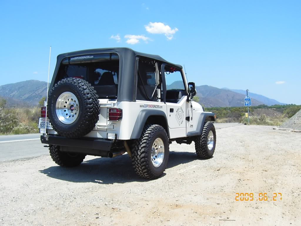

Here is my little 4 Banger, she is a daily driver and she is all I have right now. Gotta baby her.
