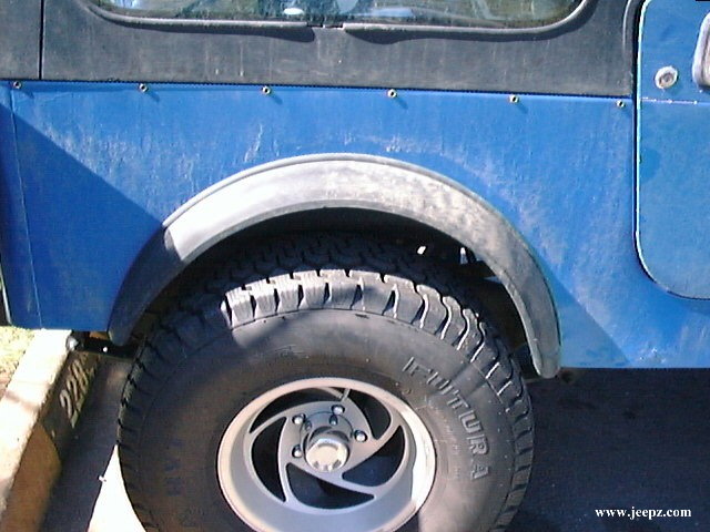

Step 1
Here's what my stock rear fender flares look like, It appeared that the wheels were cramped inside the small round flares

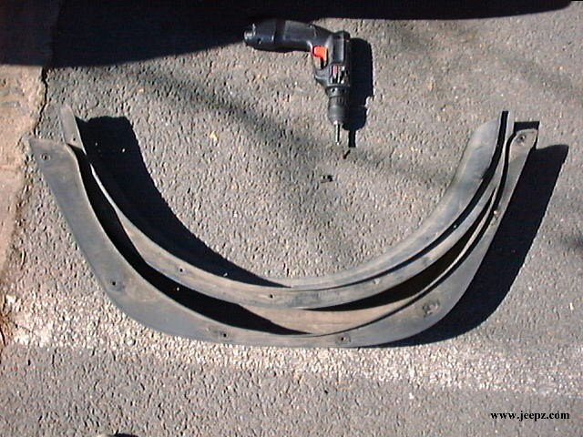

Step 2
All you need to get the flares off (and on again) is a standard hex bit, I used a drill because it is a lot easier
Step 3
Just unscrew the bolts, and get the flare off, then use the old flare a a guide and drill matching holes in the new YJ flare

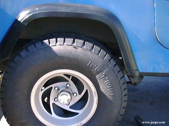

Step 5
Just screw the new flare on. Although the fenders aren't trimmed at all it looks like the wheel has a lot more space, and seems to have a more up to date appearance.
