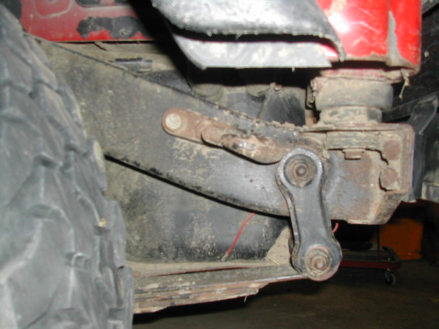

Another heads-up that I learned the hard way is that exhaust pipes = burnt straps = snap. Does anyone know of a good tow point for the rear of a YJ. The only thing I can find is the slot in the frame behind the rear tires which only works with a hook strap... ? thanks. jered
Two grade 8 bolts all the way through the frame. It's best to sleeve the frame, but I didn't and have had no problems.
