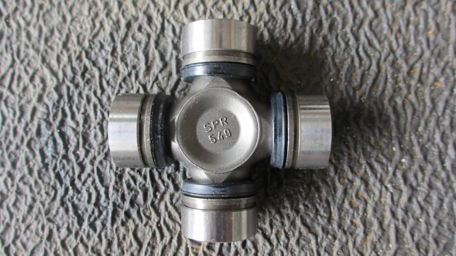

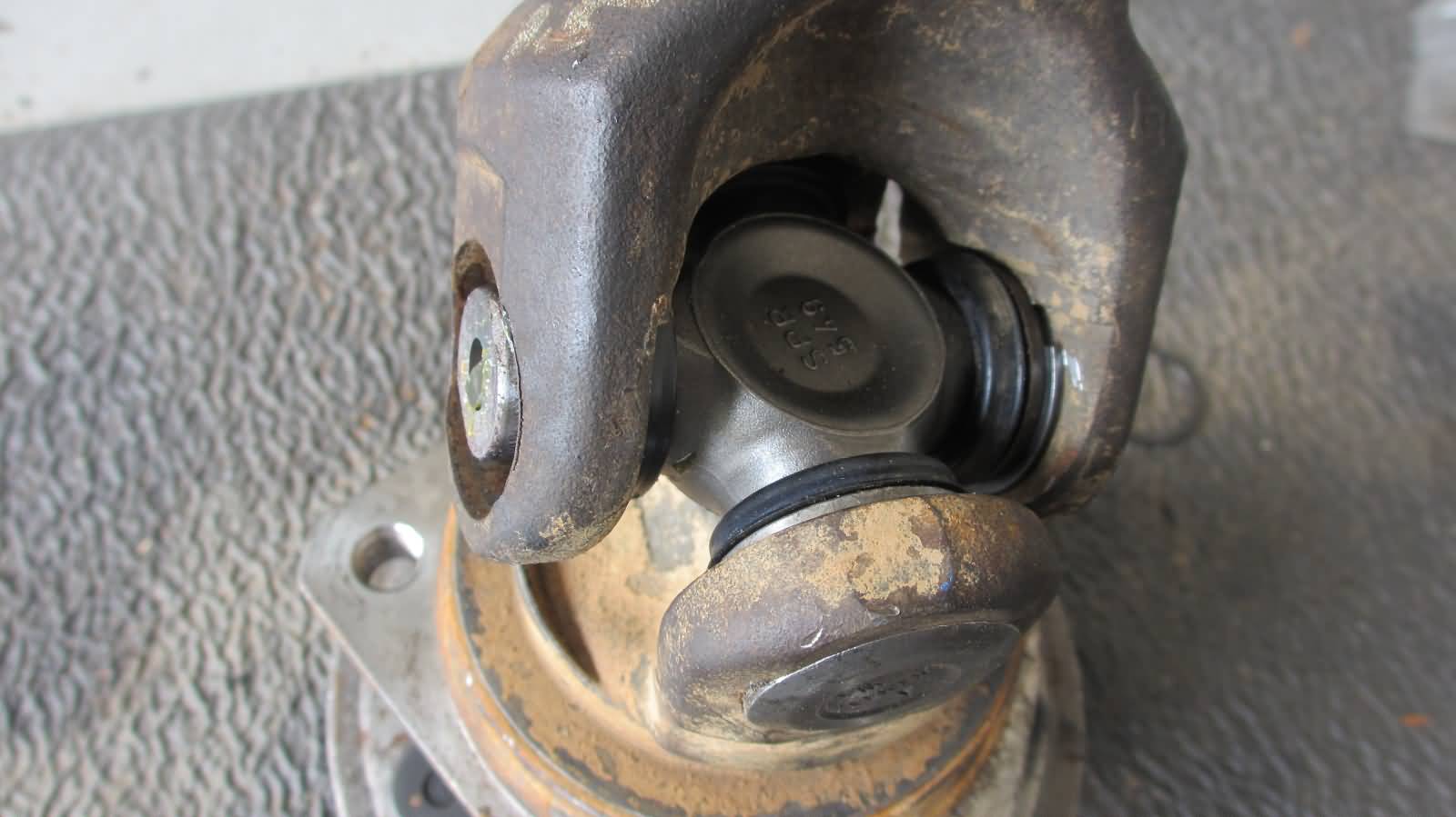

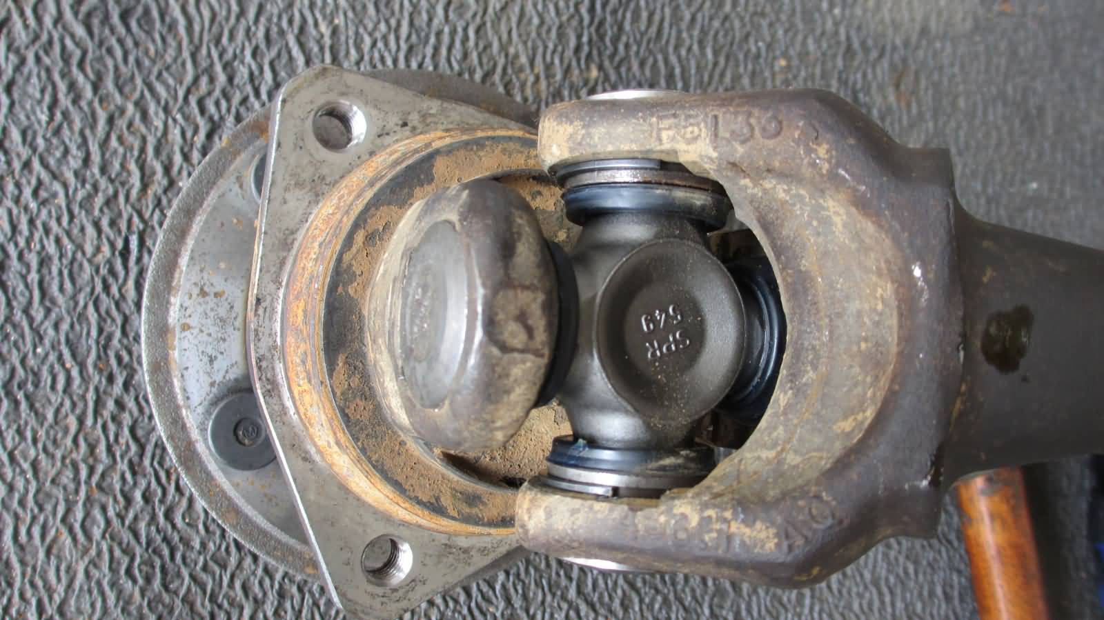

I replaced my axle u-joints with some Spicer 5-760X U-Joint Kits that I purchased on amazon. At less than $25 per u-joint the price isn’t too bad. Here’s what a new axle u-joint looks like:

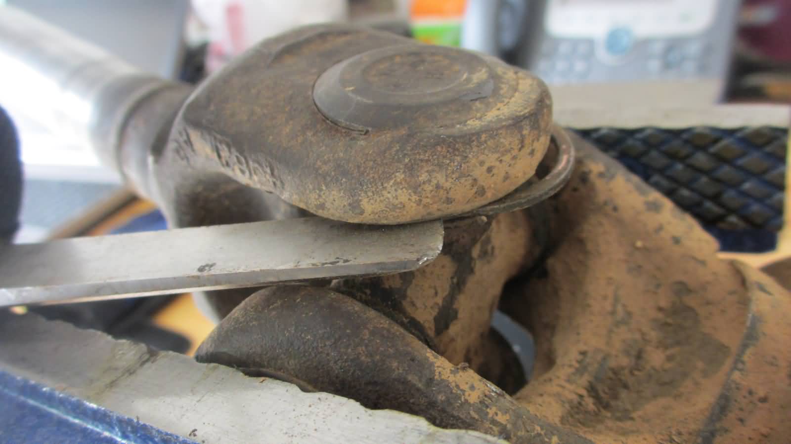

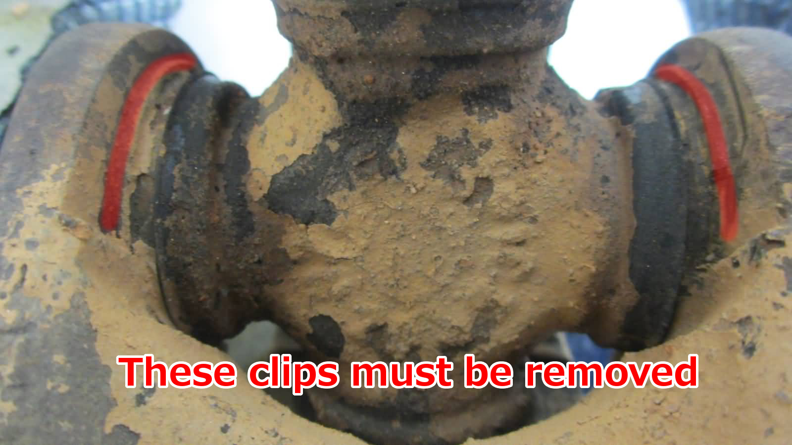

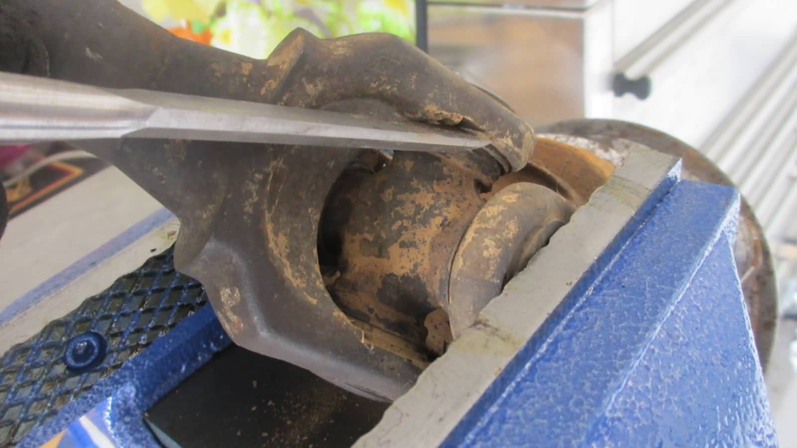

- Next, you’ll need to remove the clips that keep the old u-joints in place. You don’t need a special tool for this – I use a wood chisel, but I’ve seen others use pliers. The idea is that you just pop off the clips. The clips actually come out quite easily.

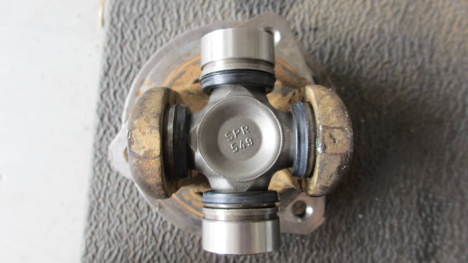

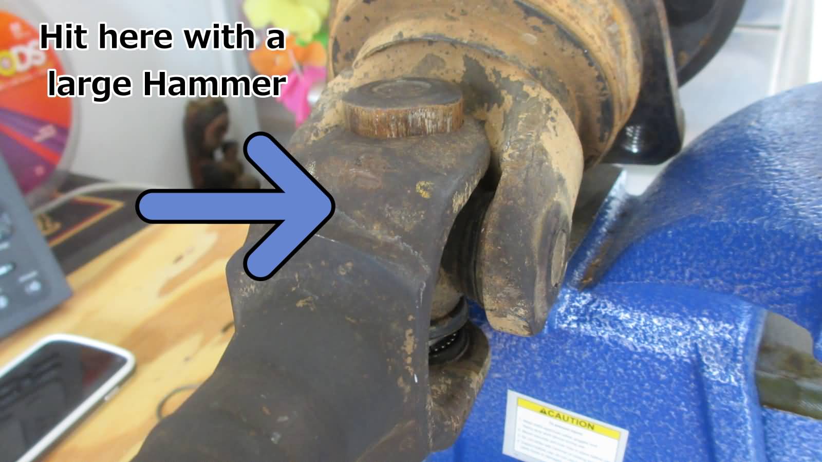

- Now, we’re going to drive out the u-joints. There are a couple of ways to do this. I decided to support one half of the u-joint, then hit the other side with a hammer, in a downward motion. You can see in the photo below that the cap has popped out of the axle.

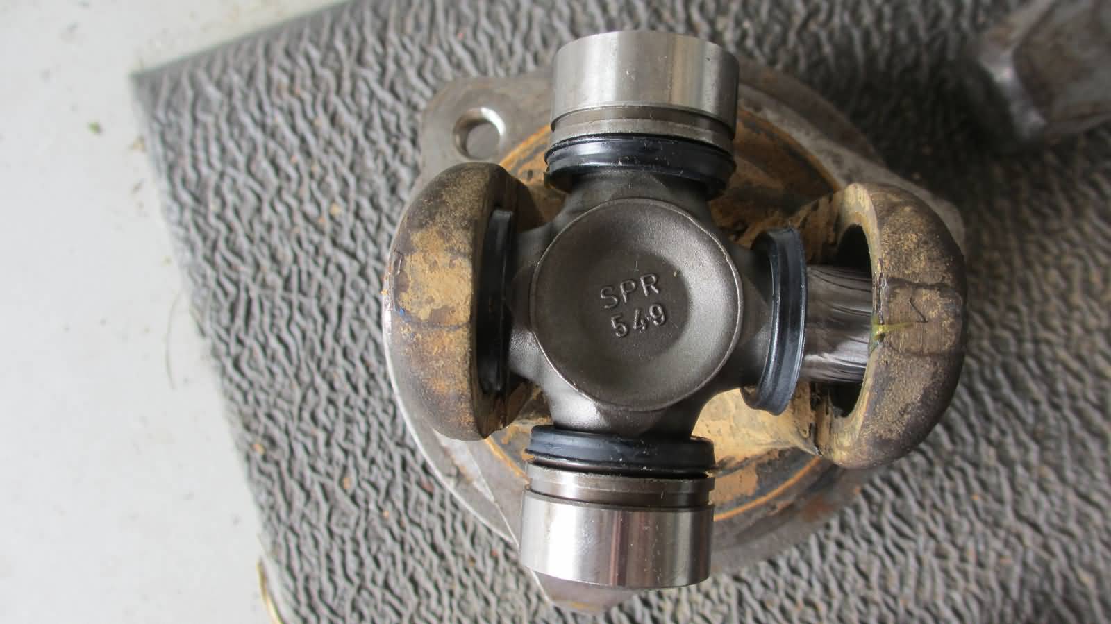

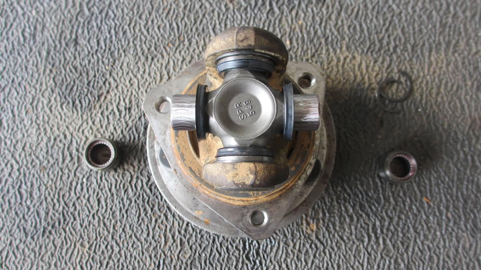

You could also use a vice to press out the u-joint. Just put a large socket over one side (the u-joint will pop out into this socket), and a smaller one on the other side to press the u-joint in. This method of using sockets will also work by just using a hammer to pound the caps out. - Once you have the old u-joint out, you’ll need to put the new one in. You’ll want to remove the caps from two opposing ends of the new u-joint (keep track of what cap goes where – they are machined specifically for that spot, and shouldn’t be mixed up). With the caps off it will easily fit in the yoke. Then carefully put the cap on one end, and tap it into place with a hammer.
- Then do the same for the other side.
- Remove the other caps, and do the same as before, putting one cap on at a time.
