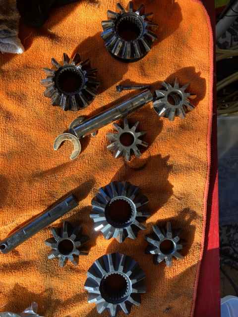

So quick question.
My old carrier gears have 14 teeth for axle side gear and spider gears have 10 teeth.
Replacement gears have 13 and 9 teeth respectively.
Seems to be an ok arrangement. Same size diameter and fits axle ok.
Is this normal?

As far as the spider gears I dont think it matters as long as the entire set is replaced. Be sure they fit tight. When you get it all back together. Dry spin the axels to see there is mo play or binding. You should be good to go.
The lower tooth count look beefier.
