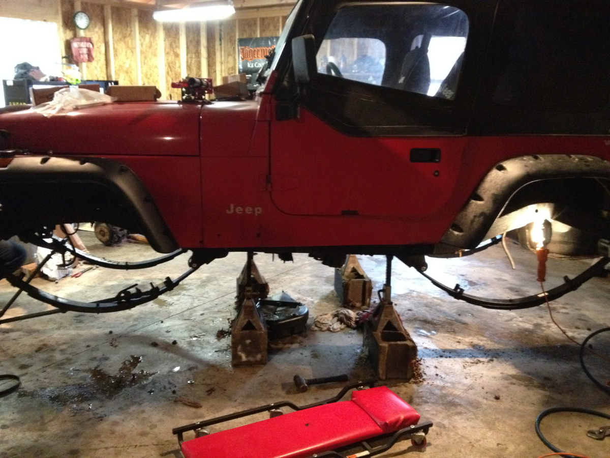

On stands ready for the tear down

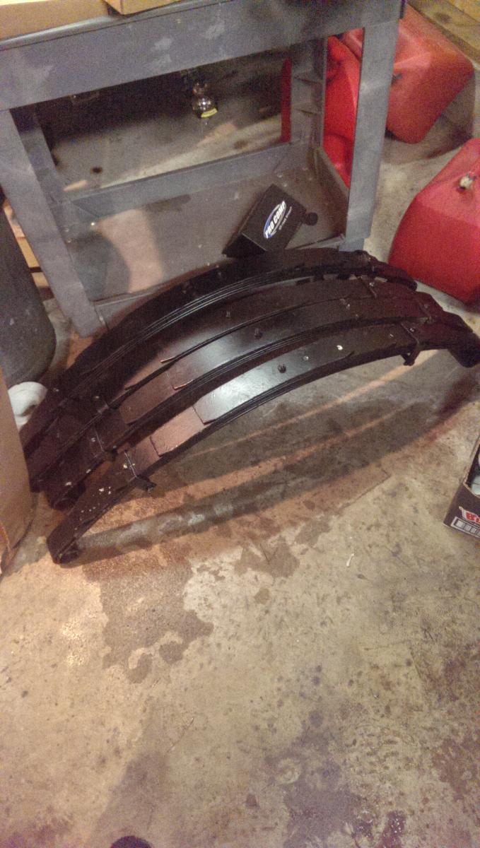

new leafs 4.5 inch Rubicon express

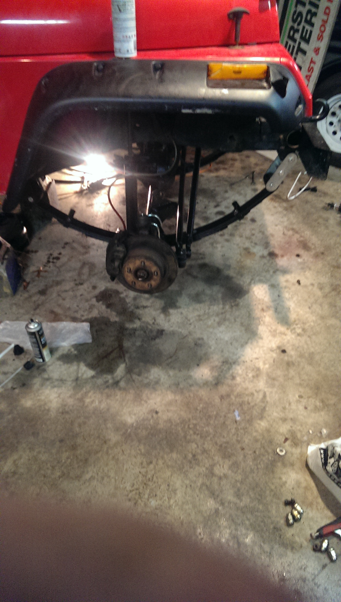

Returning to stock shackles those were installed by the po and have caused a lot of headaches glad there outta there
Man, those cinder blocks under there is not a good idea.

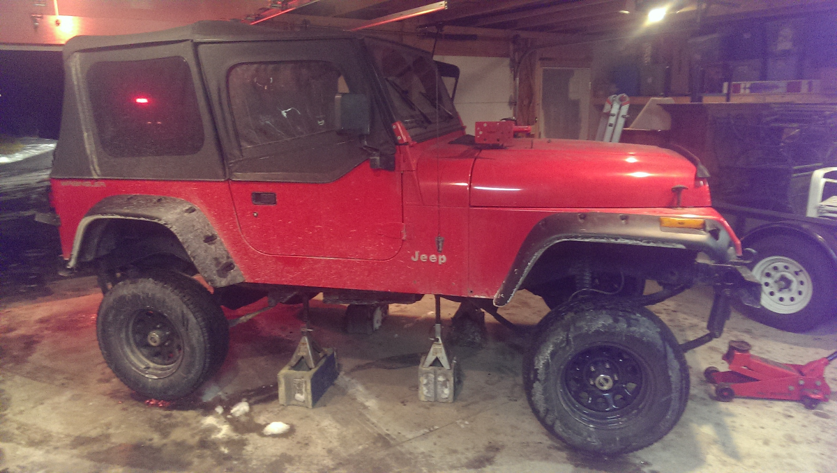

So far so good about halfway there old springs,shackles,and axles out working on getting the transfer case in after lunch then throw the axles in bolt everything up dolly it outside to put my tires on or it won't be getting out of the garage haha
cool! Ya got pics? Still dont like the cinder blocks, unless ya got a board on top of them, just putting in my 2 cents. Darn I'm jealous cause I aint got a jeep project.
Old axles springs and shocks out. New springs and shackles on

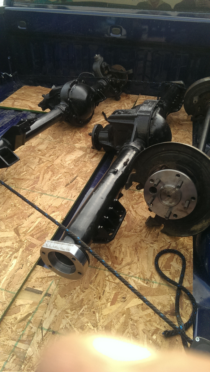

Left a hp Dana 30 out of a 96 Cherokee and on the right a ford 8.8 out of a 98 explorer. The Dana 30 is equipped with an e locker and the 8.8 a good old Detroit

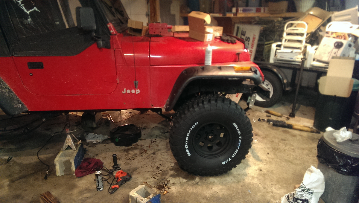

Front completely installed with tires on ready to roll 35x12.5 on 15 inch pro comp alloy rims

As for them cinder blocks it was a little dicey sometimes so we got the front end done before we did anything else just for a little more stability so I'm not as worried as I was it's all down hill from this point I'm surprised how high it sits I wasn't expecting it haha Idk how the hell I'm gonna get in it
