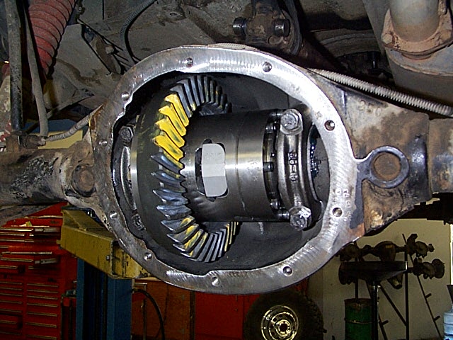

Photo of a Dana 35 with an mechanical locker installed:

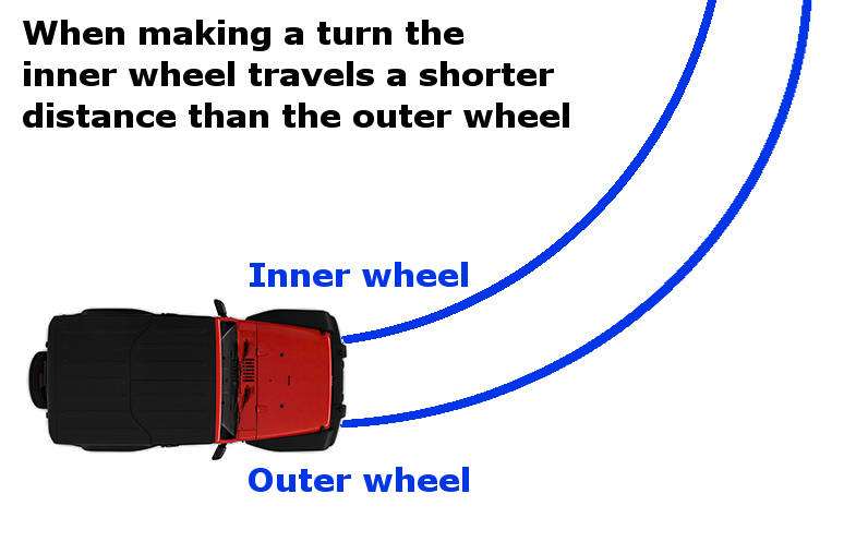

When you make a turn the inner wheel travels a shorter distance than the outer wheel, and during the turn the spin at different speeds, as you can see in the picture below:
If you have mechanically locked the wheels together, then you'll have a hard time turning since both tires will attempt to travel the same amount of distance, causing some strange handling problems. This is why there are several types of lockers that allow you to manually engage and disengage them.
