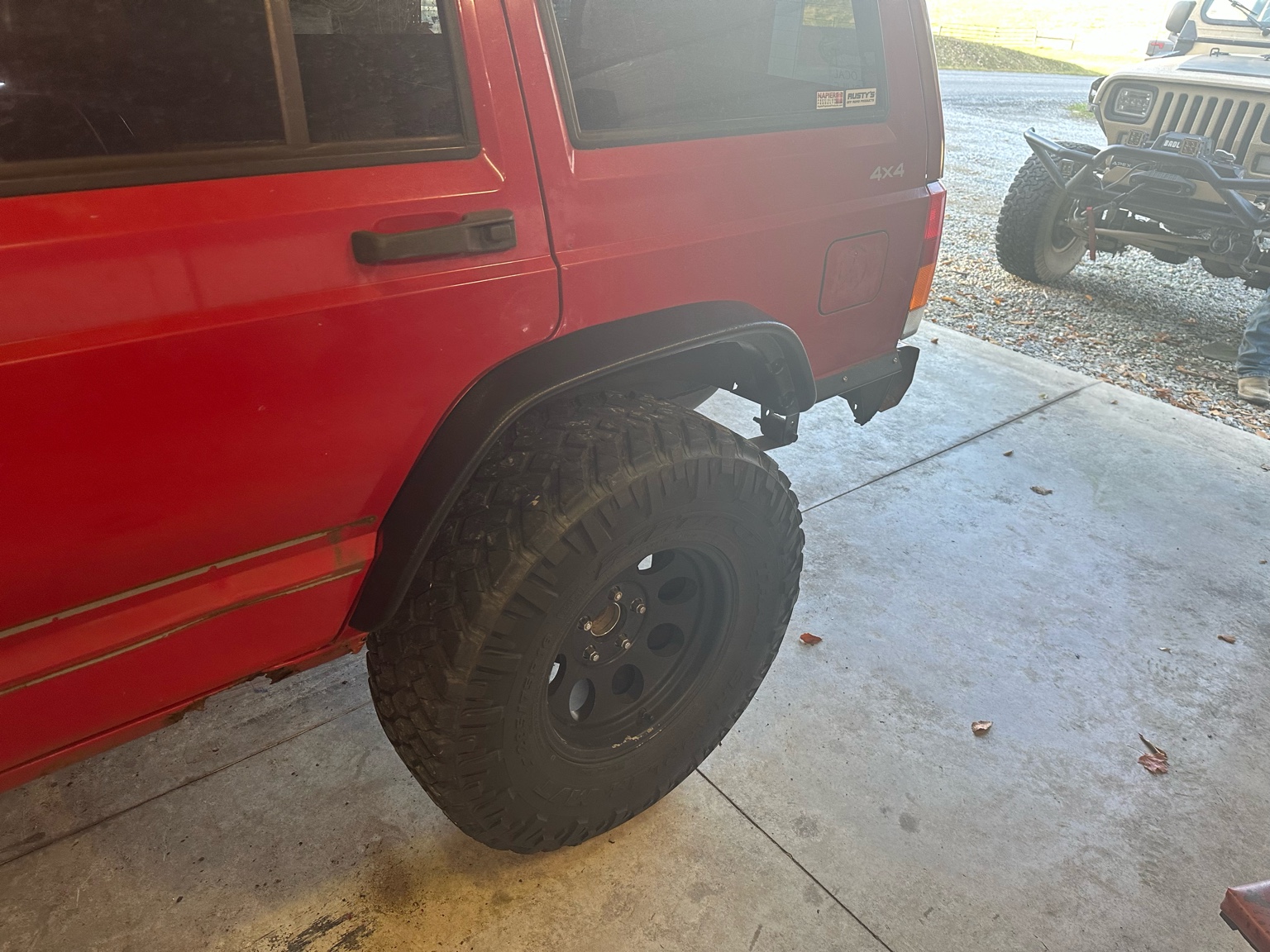

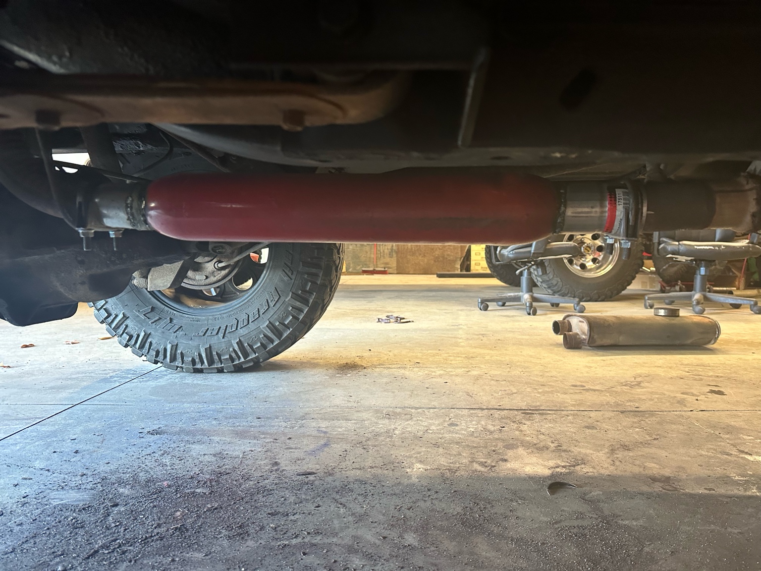

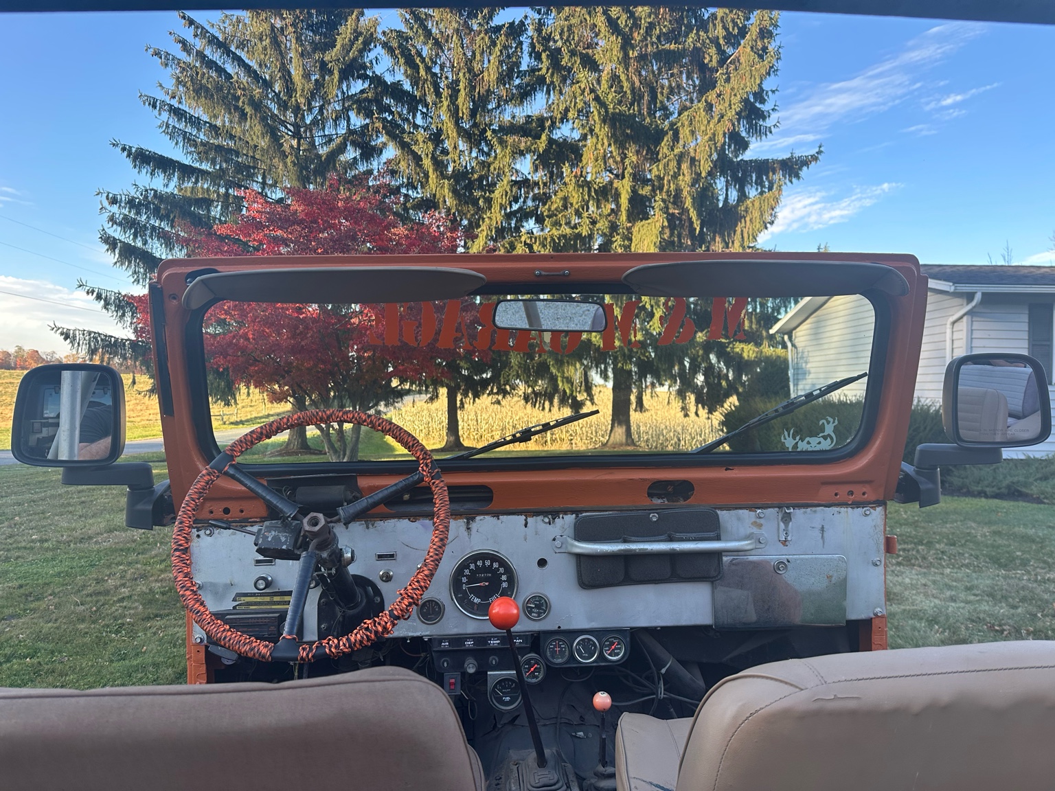

Finished the rear Napier flat flares on my buddys cherokee, tossed on a glass pack (I advised against it) and replaced a worn idler pulley.
Also put a used JK rear view mirror on my CJ5.
How was the glaspak?

Obnoxious, I apparently went and got old as I used to run one on my TJ, but it’s too loud for me now. Lol
i grew up with glaspaks and straight pipes on cars too. i wonder how it would sound for me, ha ha ha. probably too crazy to me too

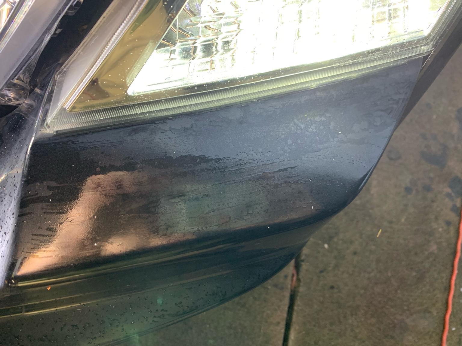

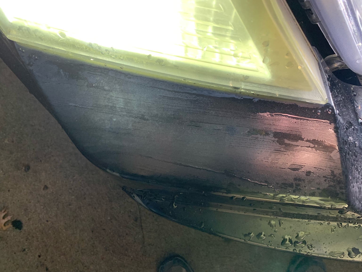

Replaced headlight and blinker assemblies on late model liberty.
Plus polished up the bumper a bit.

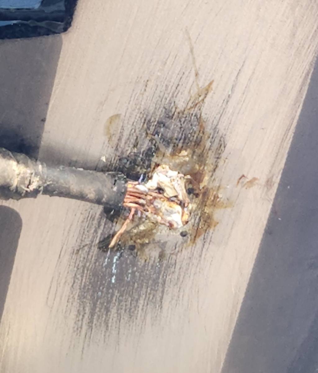

OMG this better stay connected!!!!!
Rear defogger... I've used multiple adhesives, that have failed to remain connected. I've tried soldering the original little nub... fell off.
This was a last resort! Boogered up the window with enuff solder to hold the wire and hopefully this stays connected!
Connectivity is excellent, so only time will tell. This beats paying the almost $1,500 the stealer wanted to replace the whole window?!? Really... no attempt at mak8ng a repair at all. SMDH20221124_152520.jpeg

HOW TO Fix Rear Window Defroster! DIY for under $8 - YouTube

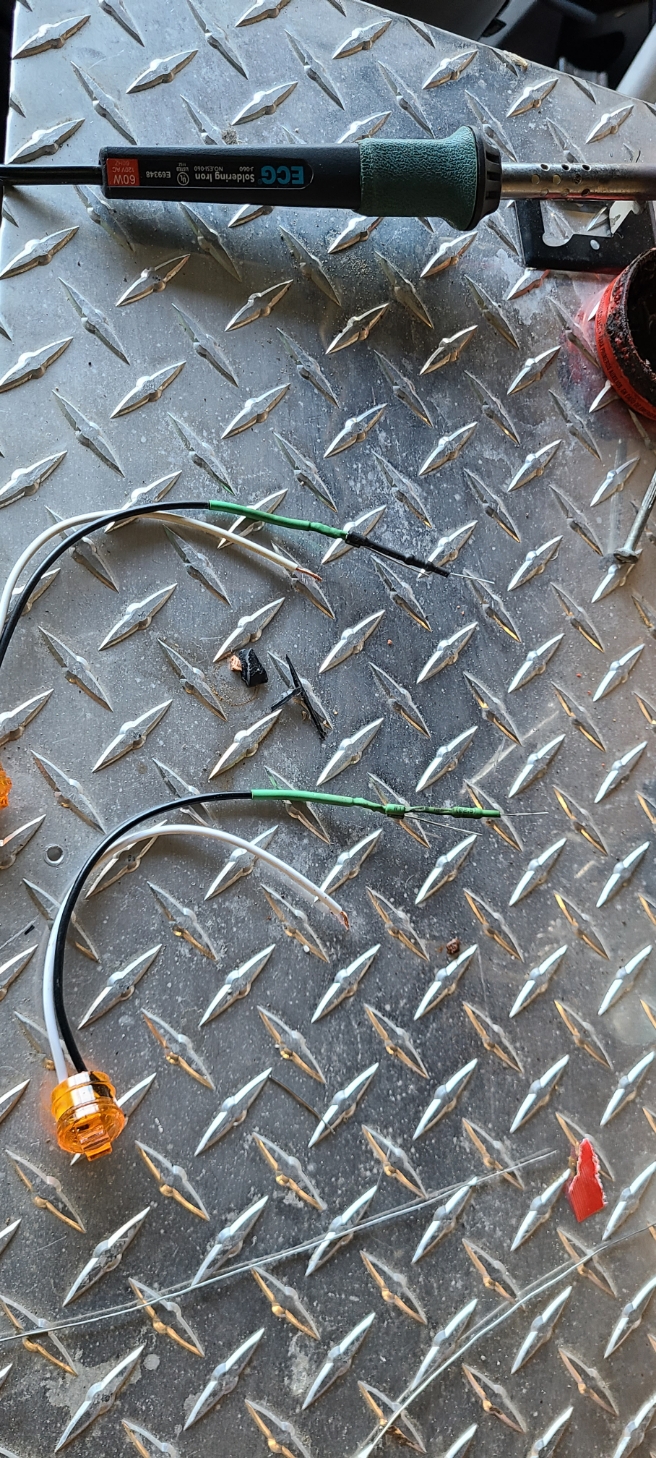

I finally built the little circuits so the leds work as turn signals and running lights, like they should. I got those installed, too. And i put the longer front shocks on and went for a ride.
This jeep is stiff riding now. The kid i got the springs from said they were on hia dad's tj but they are really stiff. Its almost like riding in a 3/4 ton truck. I winder if they were off a jku or something else instead of a tj.
Here is the circuit. diodes and a resistor and the leds in the shot and i had to heat shrink them once soldered in to the jeeps front wiring, too
This is the fenders and i think the leds are in this shot. Maybe not but you can see where they would go
Shrink wrap the wires very well right to the bulb. This is more of a Protection from the rocks and dirt that’ll get kicked up.
I wrapped it in the wire protector loom and zip tied them up where the wheels cant twar them off. Them i put that rubber spray liner, really thick and multiple coats, over it all to try to keep it safe.
Time will tell though

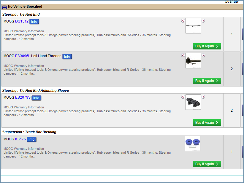

I've gotten death wobble a few times over the years, generally when things wear out. Here's what I replaced last time (back in 2019)
I've got an aftermarket JKS trackbar, and I found that the bushing wears out with some frequency.
