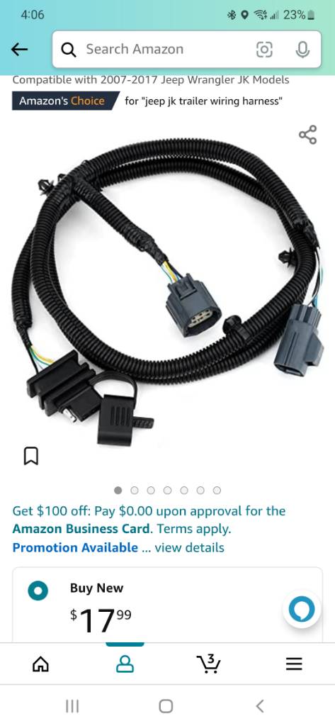

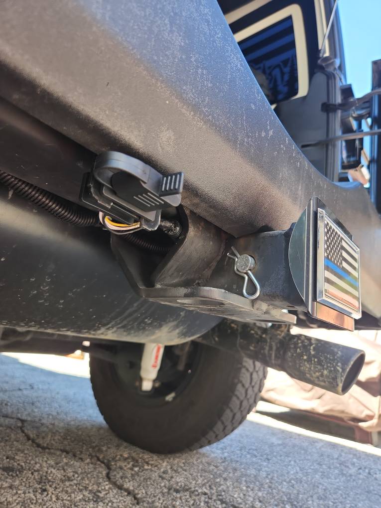

Added wiring for towing... never understood why it wasn't just there if the previous owner added a hitch.
Had to make a bracket... worked out pretty good!

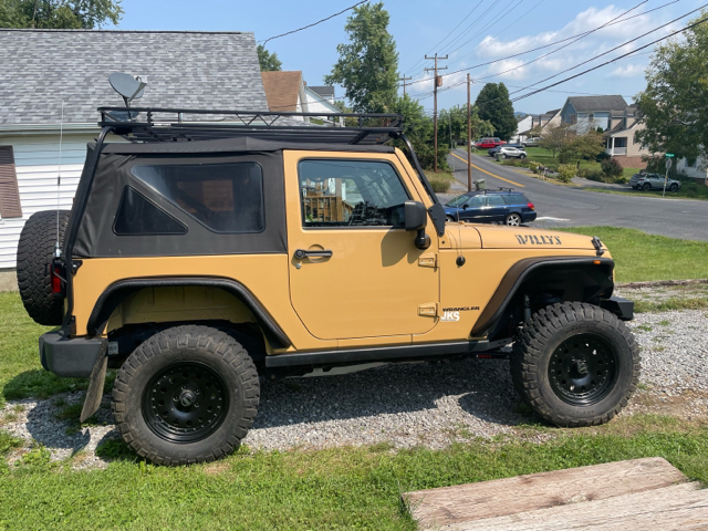

Took this to this

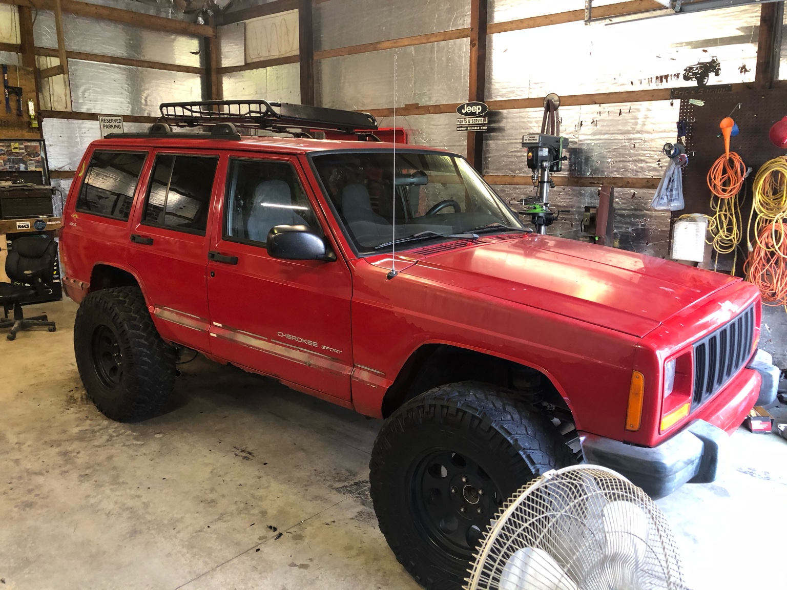

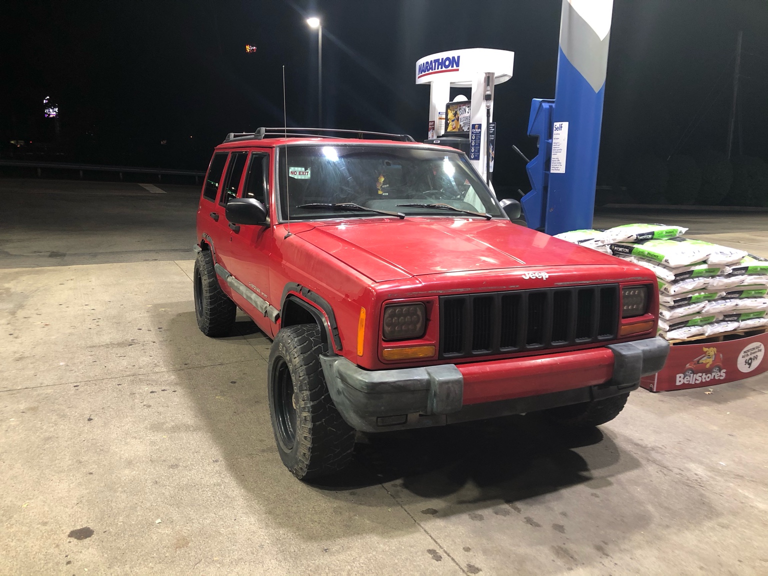

Friend got this stock with bald tires, did a budget lift (coil spring spacers, Chevy lowering shackles) and trimmed the fronts and cut and folded the rears. Clears 33’s now.

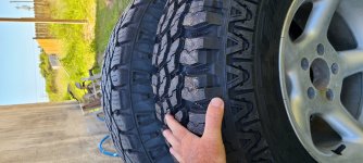

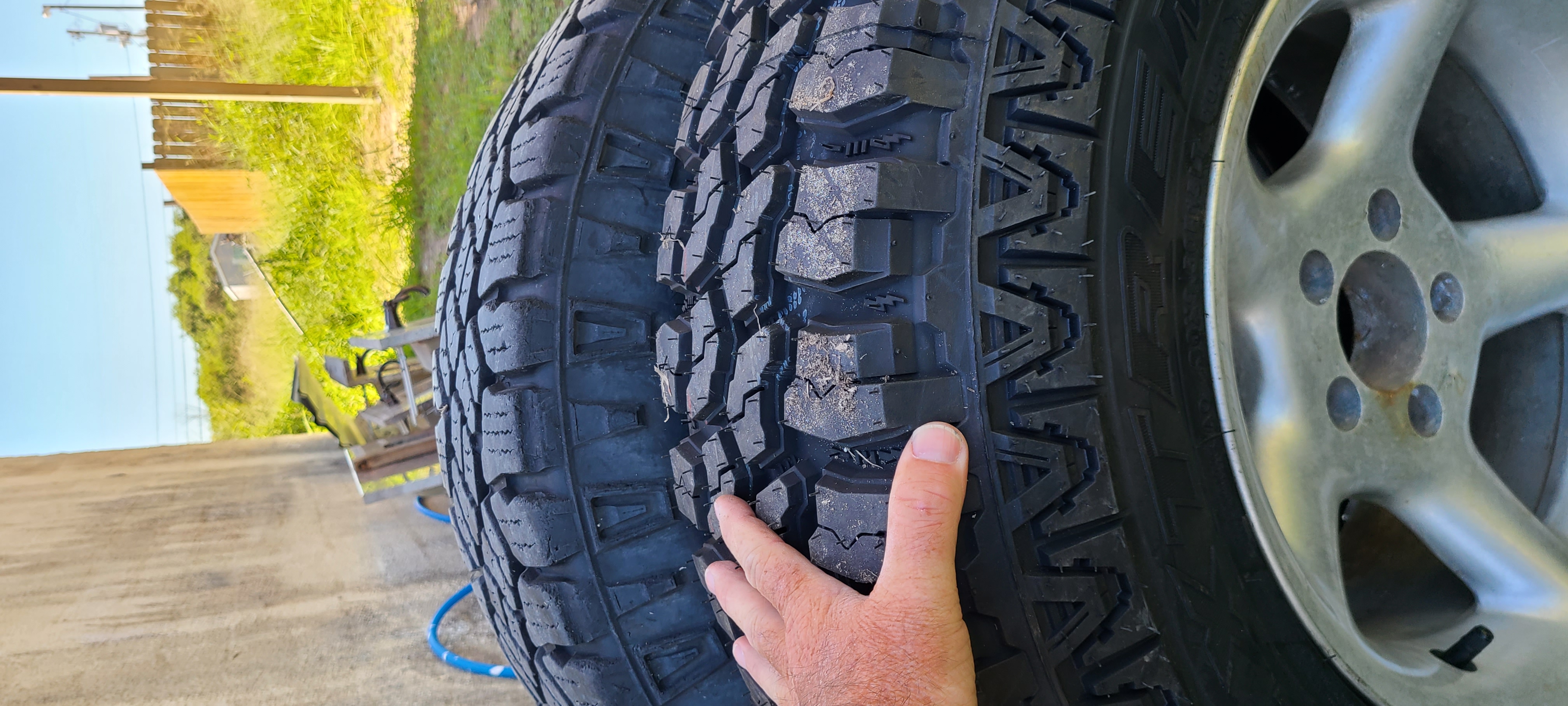

Finally tried out the new wheels. They are to small so i will try them on the ranger, instead. But, i got lots of pics for yall.
And i forgot that i cannot load pics to the site from my phone. That sucks
One attached!! This is the old tire against the new one. Supposedly a 32 against a 31

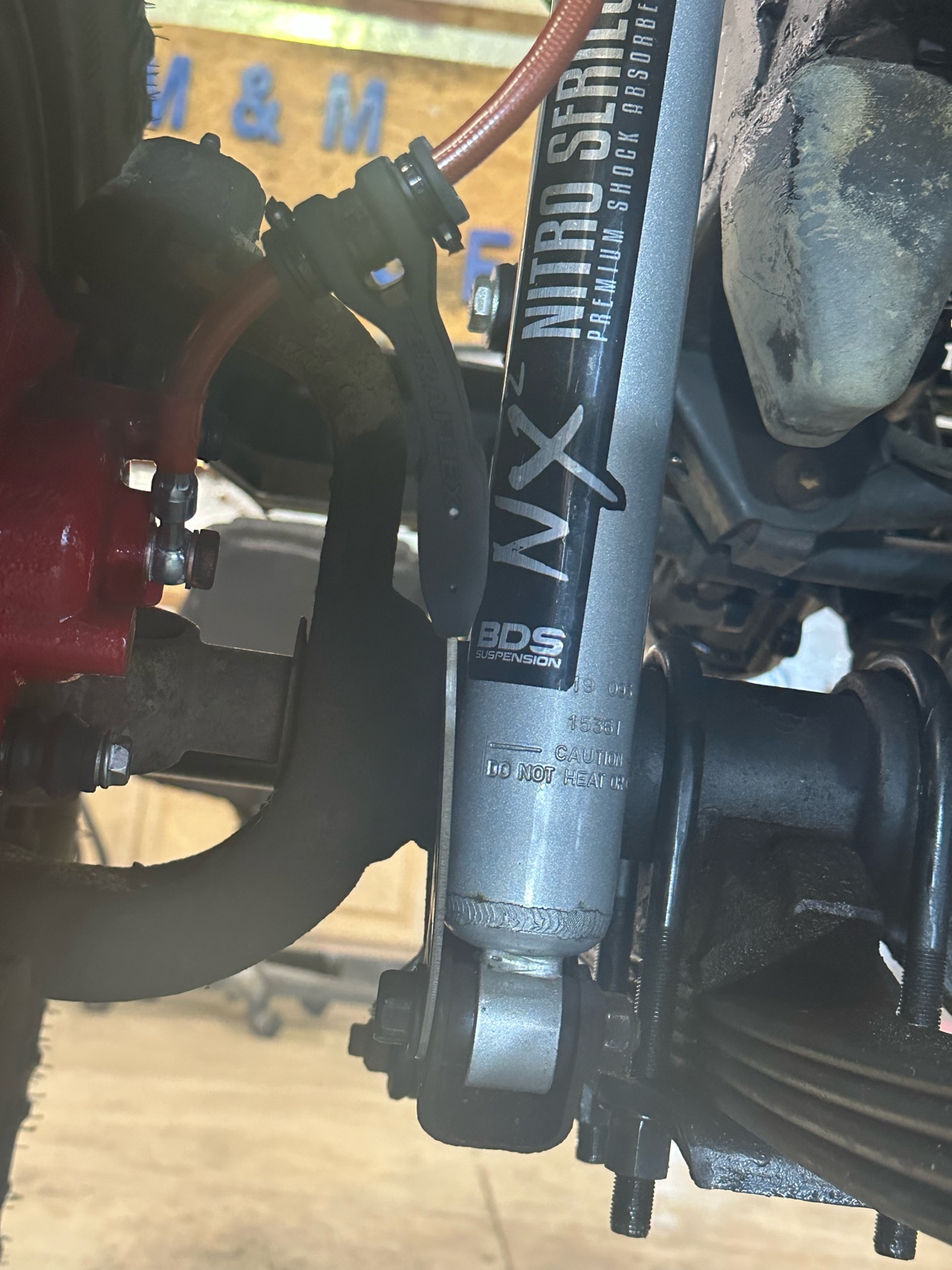

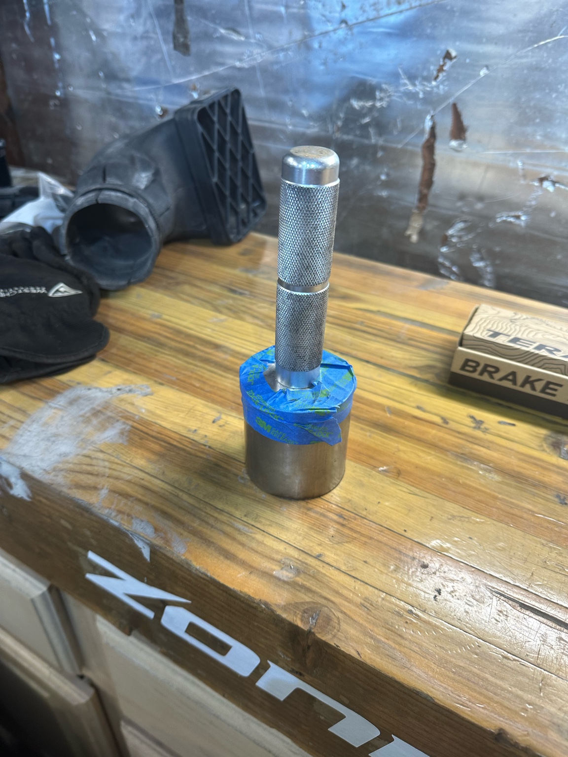

Added a Teraflex brake anchor to my dads YJ to keep the driver side brake hose from rubbing the tire. Also replaced the transfer case rear output seal, made a tool to make life easier.
