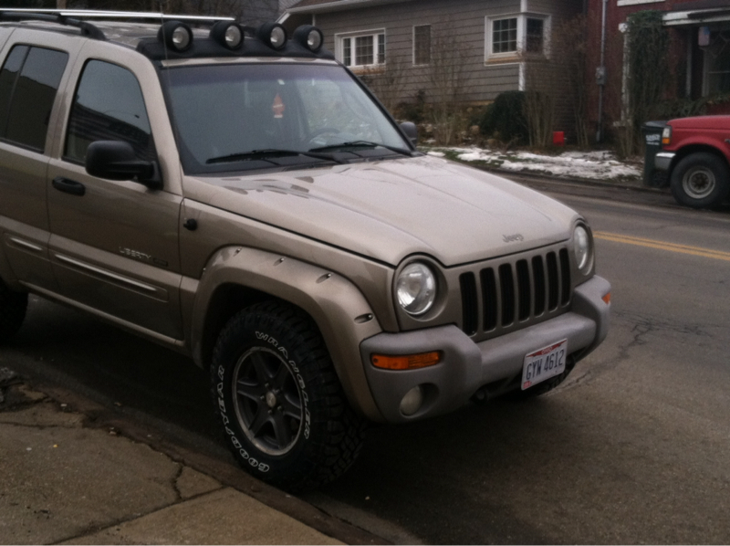

About a month ago I found a non-patchable bad spot on my tj's frame, so I parked it till spring when the long planned for frame swap and tummy tuck happens. In the mean time I picked up an 02 Jeep liberty to drive. I got it really cheap ($1800), it has a 60k mile motor and is pretty rust free (for ohio). So far I've replaced some stuck brake pin sliders and the front driveshaft cv joint. I tossed on some dura tracs yesterday and fingers crossed I will be ordering a 2" lift next week.

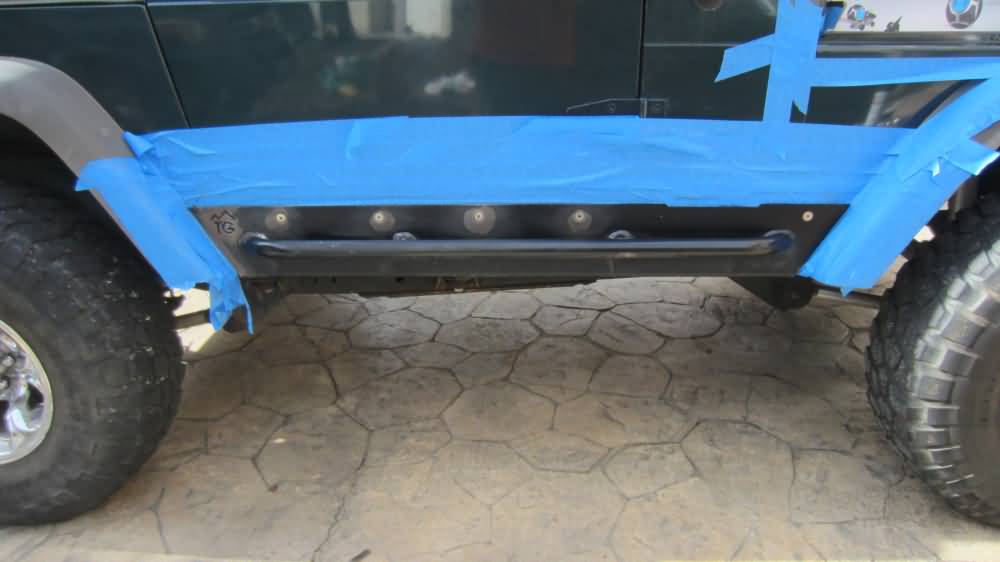

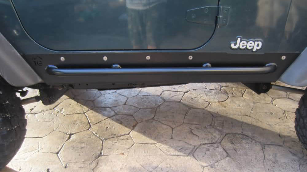

I got around to doing some maintenance on my Jeep - oil change, undercarriage rust proof, and fixing my super rusty rock slider. It was powder coated, but the rust bubbled up. I sanded it down and shot it a rattle can. I wiped everything down with Isopropyl alcohol after sanding. I've heard this is better than just blowing it off with the compressor (what I've done in the past).
It's always best to wipe the surface down with a damp rag after sanding and before applying any coating. Preprite is the proper liquid to use but a rag damp with paint thinner also works. Blowing the dust off just redistributes it while a damp rag will pick up the dust, just be sure to turn or replace the rag as needed so you don't just smear it around.

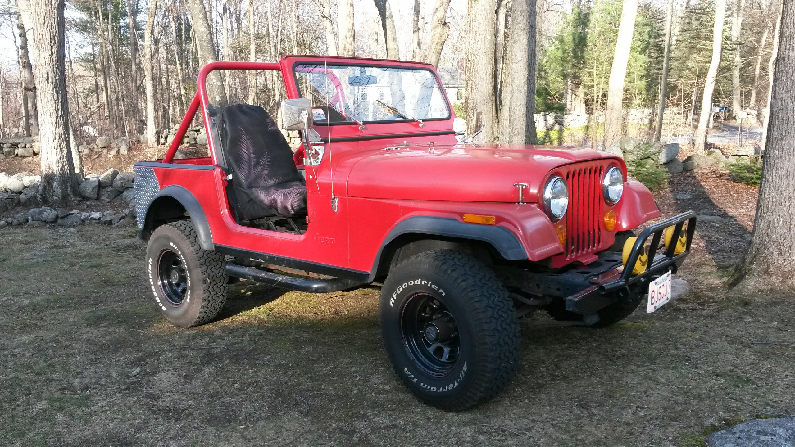

Took a step to get the old girl ready for her 35th summer (20th with me)...
Now there's a good looking, what I call a Jeep.
Er......uh......... took a step? New paint and rebuilt the engine?
