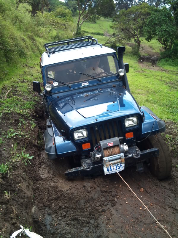

As for the mud, I have winched myself up a slope with mud up to the sidewalls without having to spool out all the cable (had at least 2 layers on the drum) with my Superwinch EPi 9.0. According to the respective web sites, this is the pull capacity per layer for these 2 winches:
Layer
Layer Superwinch EPi9.0 Warn M8000
1 9,000 8,000
2 8,190 7,280
3 7,500 6,670
4 7,010 6,230​
5 6,570 N/A
By the way, this Warn with 9,000 lbs capacity had no problems geting this Jeep out; notice that there's still line on the drum (a couple of layers):
That's a pretty heavy Jeep, as it has 39.5 tires and a bunch of other stuff (winch, hard top, I6, and a bunch of other goodies).
