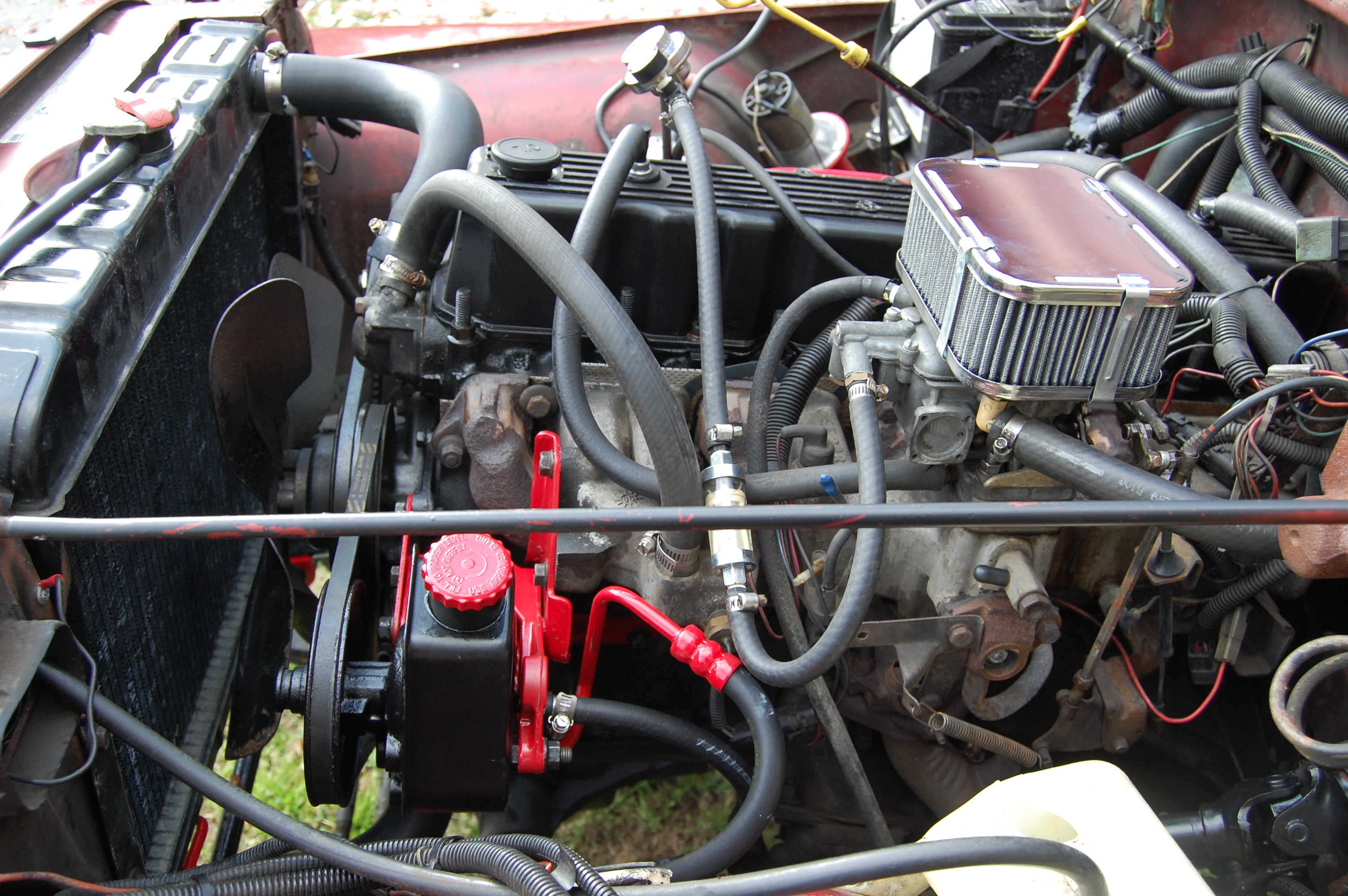

It not likely you are low on power steering fluid causing a problem........... But if you have power steering, unsder the hood you should see something like this:
The red cap and reseivor is the power steering pump (yours will likely be black) and you should see some hoses leading to the steering gear which is under the front bumper. If you have these parts, start small and work towards the larger (more expensive). First, is the drive belt still connected to the pump? Is thier fuild in the reseivor? (however, it would be wining really load if it were that low).
If you have manual steering, they are just hard to turn, especially with larger ties.
I knew I had a front photo somewhere, see in the upper right hand corner of this photo that box with a big round cap looking straight at you? That is a power steering gear box.
