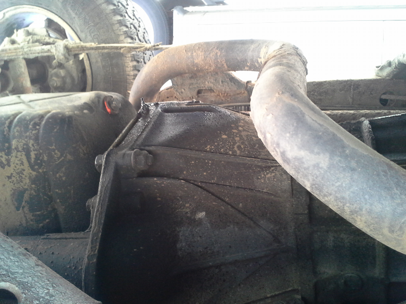

Im leaking what looks like gear lube between transmission and transfer case (I think). What could be the issue/fix? Is it the clutch?
1995 YJ 4.0L V6
Between transmission and engine it looks like. Hoping it's not a costly fix :( as I'm about to drop money on a new radiator though I think that'll take a back seat to this issue
1995 YJ 4.0L V6
How much fluid are you loosing? Does the fluid stink bad (meaning it's transmission gear lube), or does it look and feel like engine oil?
I'm guessing that you're leaking engine oil, and that it's a leaky rear main seal (where the engine mates to the transmission).

Ya it's a leaky rear seal it'll get fixed when I do the clutch unfortunately my break caliper seized up today so had to fix that ... jusy wasn't my day
