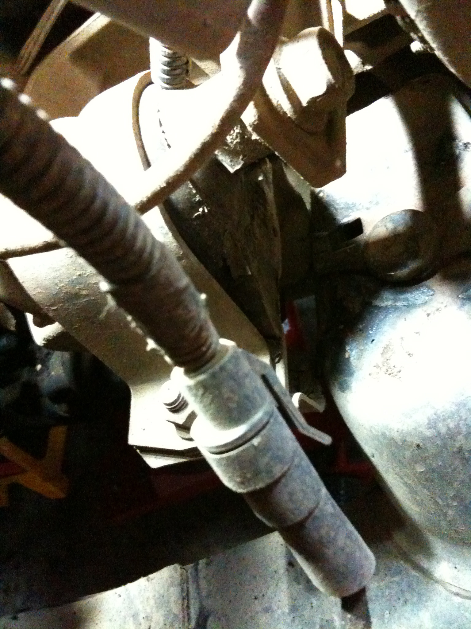

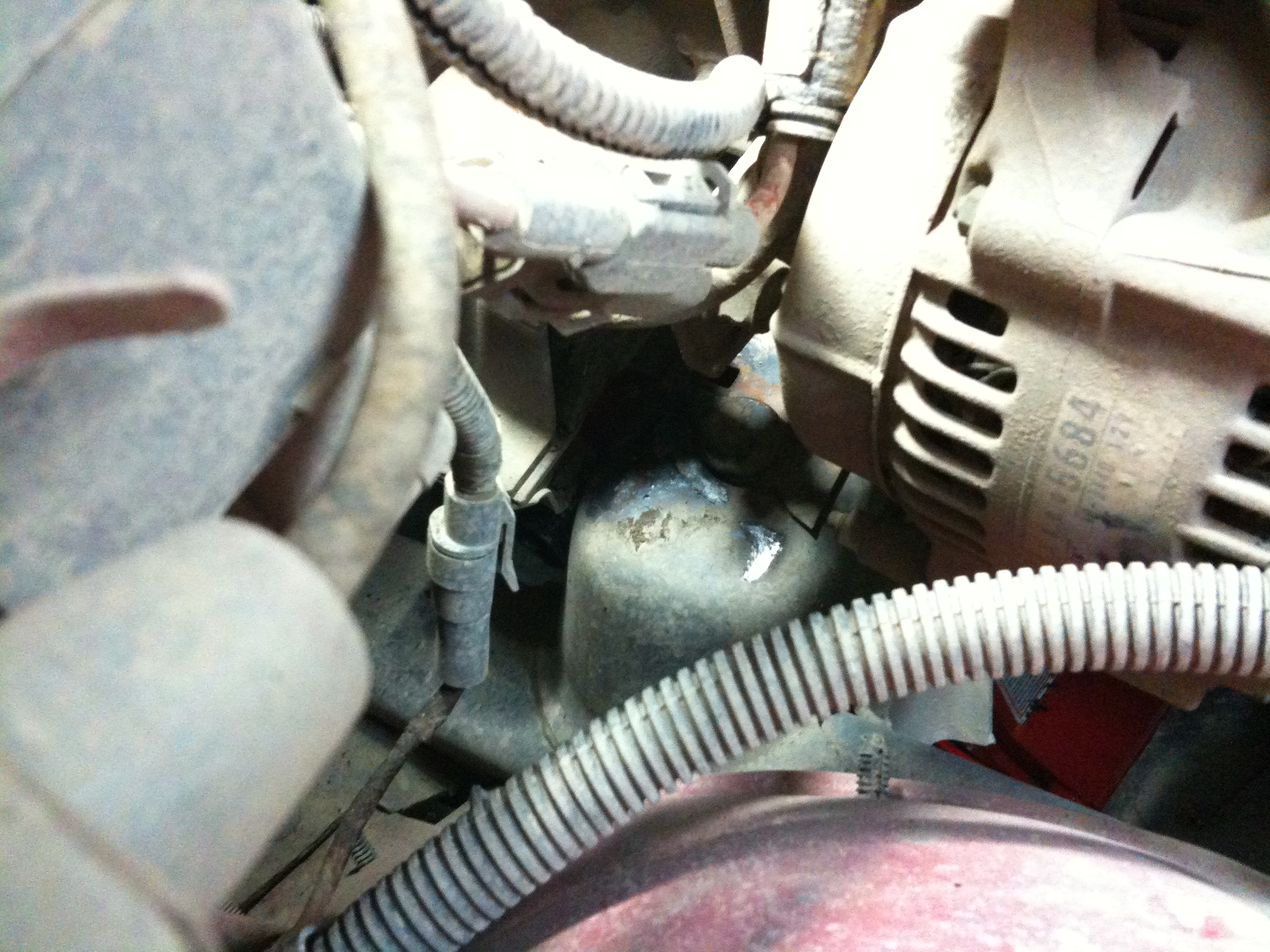

Thanks for the input. I found the problem though. The passenger side motor mount had broken and slid back off of its stand. This caused the transmission to not go over far enough. Just need to replace the motor mounts and we will be good to go!

i was going to say you might want to check your motor mounts. i had broken bolts holding the mounting arms to the block on my wrangler
