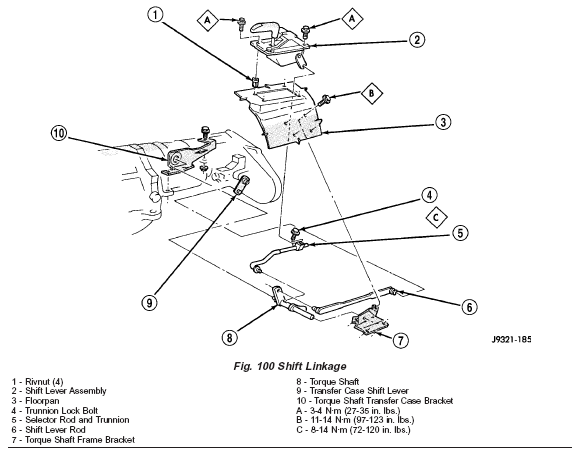

A while back my t-case took a poop because of the front drive shaft... new case didn't come with any linkage & mine was all mangled. Does anybody have a pic of the linkage? my Jeep is an '05 TJ X auto trans if that matters.

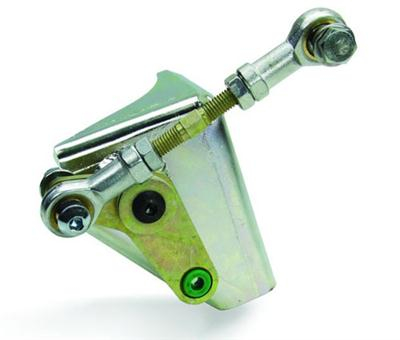

I don't have any pictures, but if you've got it torn apart now, I'd get the linkage upgrade kit to disconnect it from the tub. It shifts so much firmer and doesn't bind up at all now. I got mine from Advance Adapters I think.

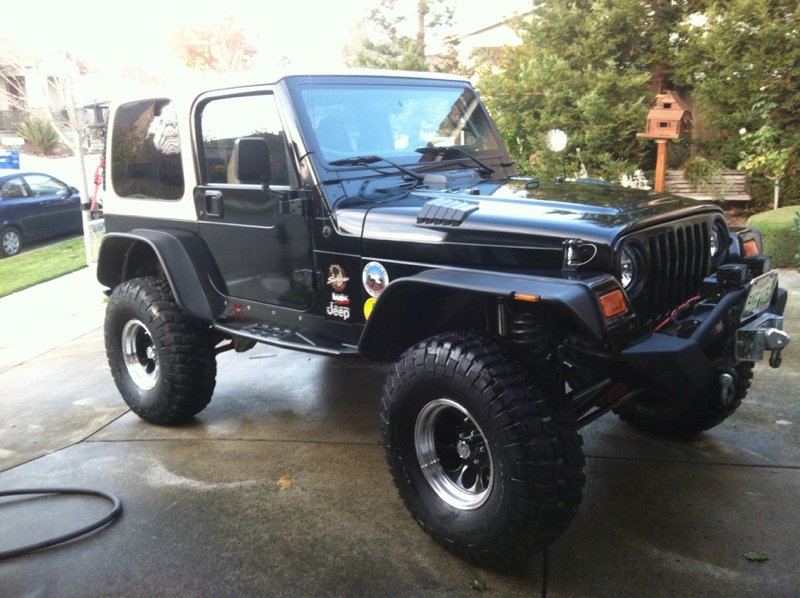

My 2000 TJ was popping out of 4 low. I put on the Teraflex transfer case linkage and solved the problem. Automatic also. Gratuitous Jeep pic..
