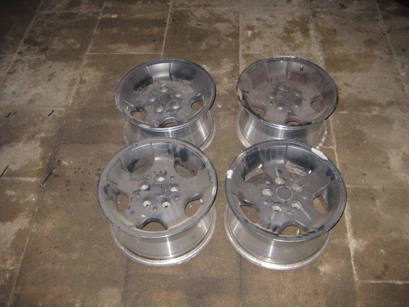

I bought a set of 4 Sahara TJ rims. 15x10 for a reasonable price. I have 33 x 12.50 15 tires . Will they rub? I am going to use this set of rims for offtroading. I currently have 2655 75 r15 installed on stock 15x8 rims for the autobond :)

As far as I know, Jeep have never mass produced a 15x10 rim. The only 10" wide rim I can think of was on the SRT* grand couple years ago, but the diameter was 20" I think.
I know that 15x8 will work. I just wasn't sure if 15x10 would work. He told me that it came off of a Sahara TJ and it was 15x10.
