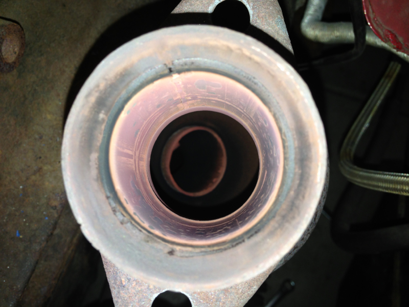

P0420 (M) 1/1 Catalytic Converter Efficiency Catalyst 1/1 efficiency below required level.
This is the CAT at the front not performing. Sounds like you have a bad CAT.
This is what mine looked like.
