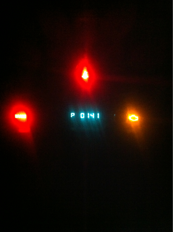

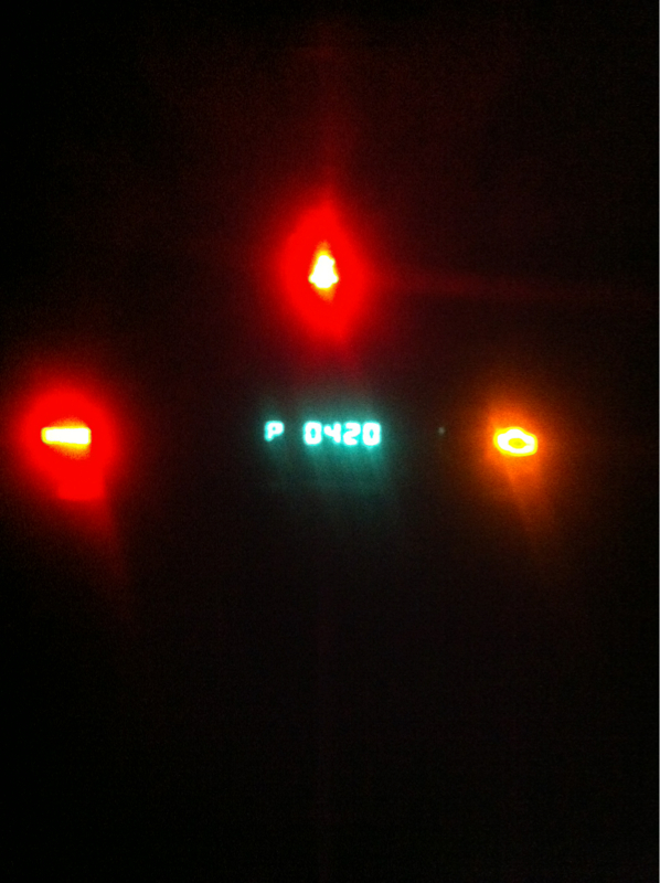

With the engine off turn the key to on, then off ,on then off then on within 5 seconds. Your error code(s) will display in the odometer. Post them up when you get them.
It should be P0xxx the x's are numbers. There mar be several. The last will be done.

Turn ign to on but do not start the engine each time for three times. Too slow or too fast will not work.
P0141 (M) 1/2 O2 Sensor Heater Failure Oxygen sensor heater element malfunction.
O2sensor near the front of the vehicle below the mini CAT.
Four possibilities.
Wires to the O2 sensor are damaged or unplugged.
Wrong o2 sensor
Cat going bad- covered up to 100k miles
Bad o2 sensor. - only by oem as aftermarket have issues.
I see. I guess I'll start with o2 sensor tmrw then take it from there but I'm sure it's the CC my tj has almost 200k
