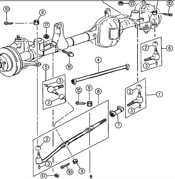

Oh, great pool of information and wisdom: I know someone can help figure this out. 1988 Cherokee 4x4, 4.0L engine, auto.trans. My understanding of this thing is that there is a center-link, a trac-bar, a tie-rod and control arms as well as a steering stabilizer. Is the right end of the center link considered a tie-rod end or is it called a ball-joint. It seems to me that the ball-joints are press fit into the steering knuckle. If so, then what is the right end of the center-link. Is it a tie-rod end? I think it's a press fit but am making myself nuts trying to figure it out. Thank you guys for any info.

Center link is from the pitman arm to the right knuckle (most times left and right in a vehicle, is reckoned as you are sitting in the drivers seat (at least the way I was taught).
If I remember correctly all the joints (except maybe the bottom trac bar and the damper) are cone shaped bolts, that fit into a cone shaped socket (all tie rod end type or like we used to call them, ball and socket LOL). I usually find a sacrificial nut, put it part way on there, leaving enough above the thread ends to protect them and wack it with a BFH (big frigging hammer).
I have a tie rod puller, but it is difficult to use without messing up the rubber boot.

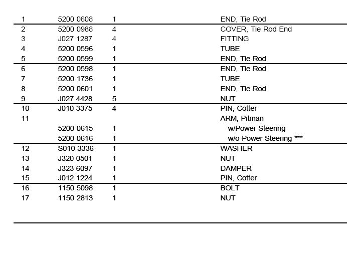

You are a true hero ! Your diagram is priceless. Part number "8" is actually a (really long) tie-rod end. The parts-guys think we're totally crazy.
