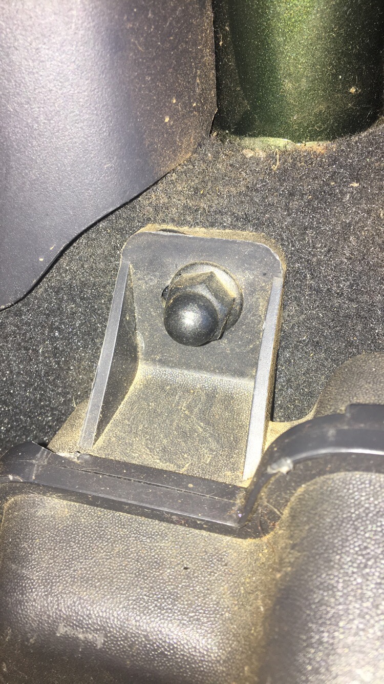

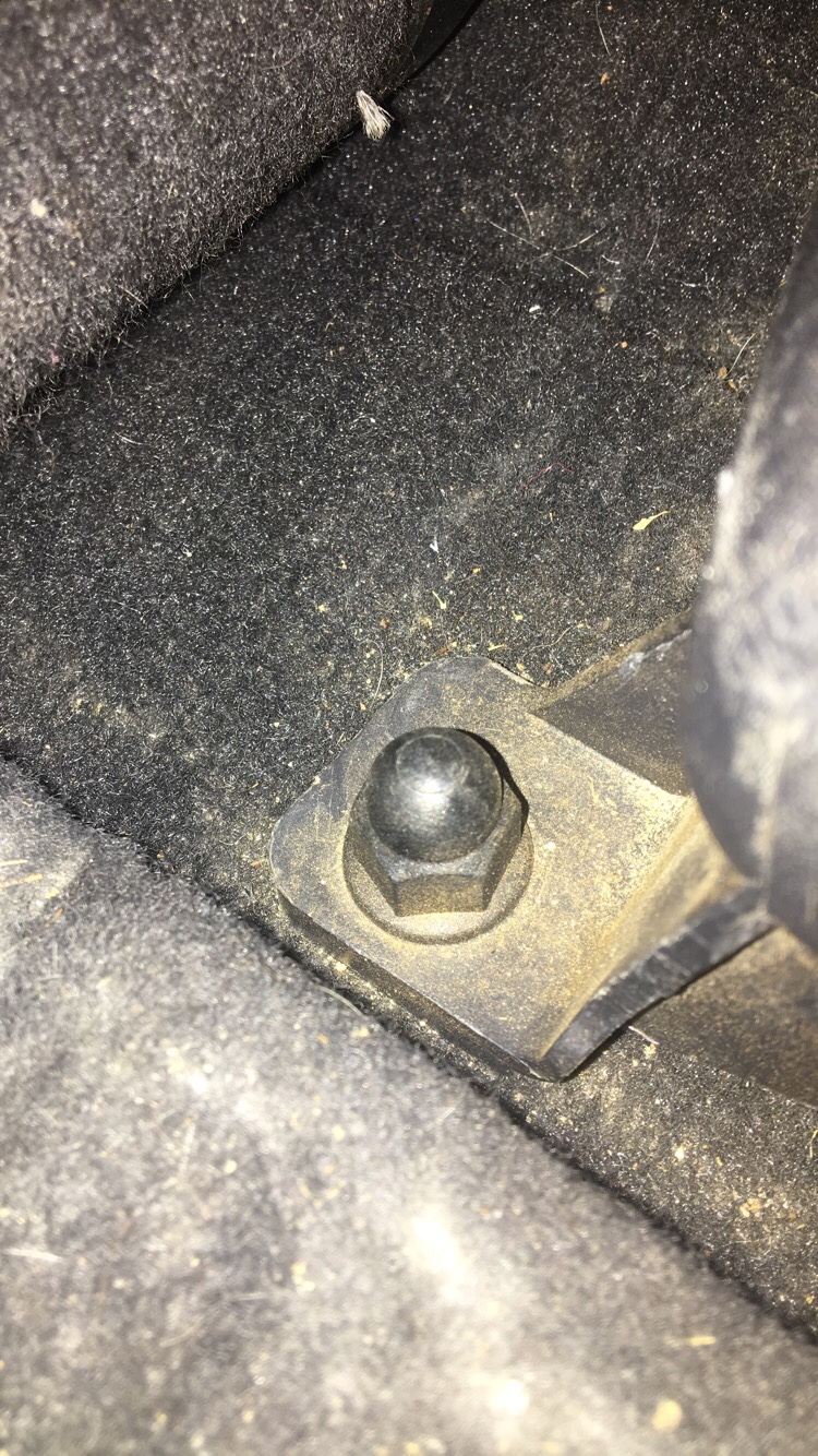

hey guys, i’m new here so i hope i’m doing this right. lol. i am trying to remove the factory subwoofer enclosure in my 2007 rubicon and i’m not sure what tools i need to use. i googled it and everything i found the guys had different kind of bolts so i’m confused. my bolts are pretty large and are 6-sided on the top like most bolts, but on top of that it has a large metal circle and i have no idea what tool i need to remove it. any ideas?

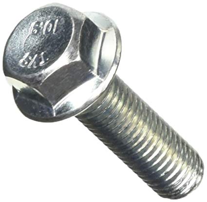

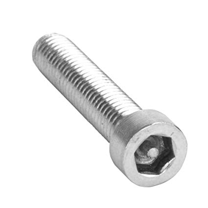

Not sure. What pic do they look like 1, 2, 3, or 4?
1

4

The bold that that nut is screwed onto is a bit longer so they put that little dome on the nut to cover it.
The best tool for this is a deep set socket:
cacheJeepzImage.php
However a wrench should work fine as well (you'll use the closed end, not the open end.):
cacheJeepzImage.php
These tools can be found at Walmart, car part sores, Home Depot, etc.
