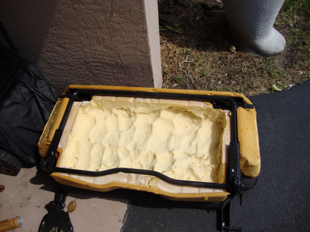

Subwoofer inside of a Jeep Wrangler rear seat

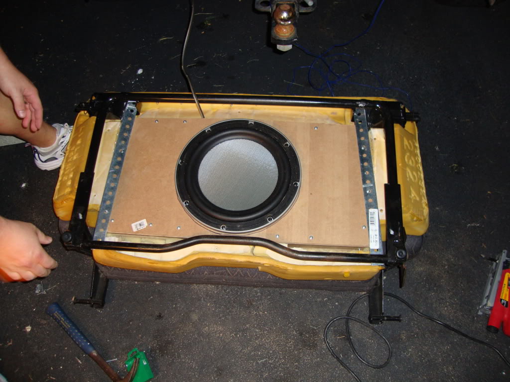

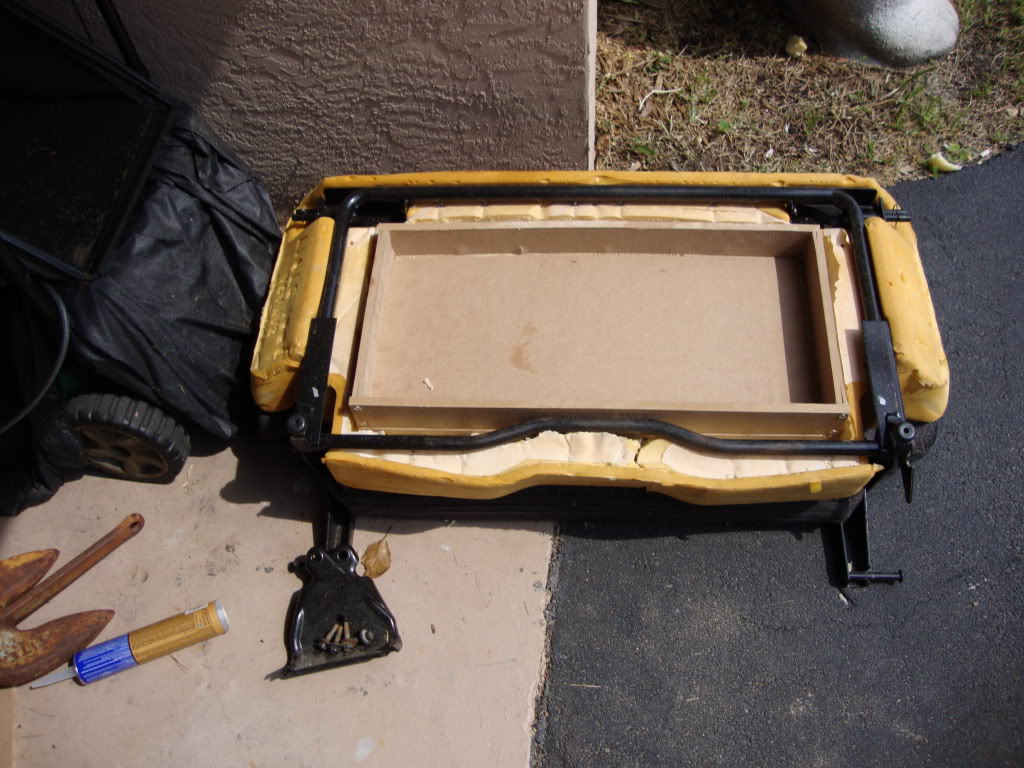

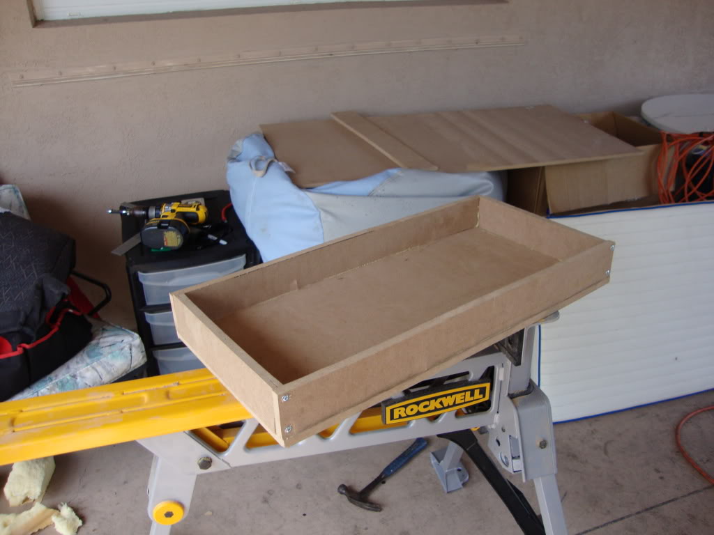

just did my install of this, I did a little bit change to the box I have an 02 tj, made the box 24 x 13 inches, and installed a 12 inch kenwood sub with a 600 watt amp, sounds great thanks for the info
Very cool - post some photos of the install when you get a chance
It was fairly easy to put together, sorry it took so long for the photos but all in all it took me about 6 hours to do, that is with runs to the store for supplies and buying the amp and the woofer

I bought I slim sub woofer, so the depth was 3 and 1/4 inches, width of 13
Hey looks great, you said that you have a shallow mount kenwood woofer, 3 1/4 deep. I have a rockford fosgate 12" w/ top mounting depth of 3 5/8" do you think it is possible to add 1" to the depth of the box. I understand this will make it not possible to zip the bottom carpet back on and will probably have to raise the seat some, but besides that do you think it would work??? Thank you, appreciate any help on this....Kenny
