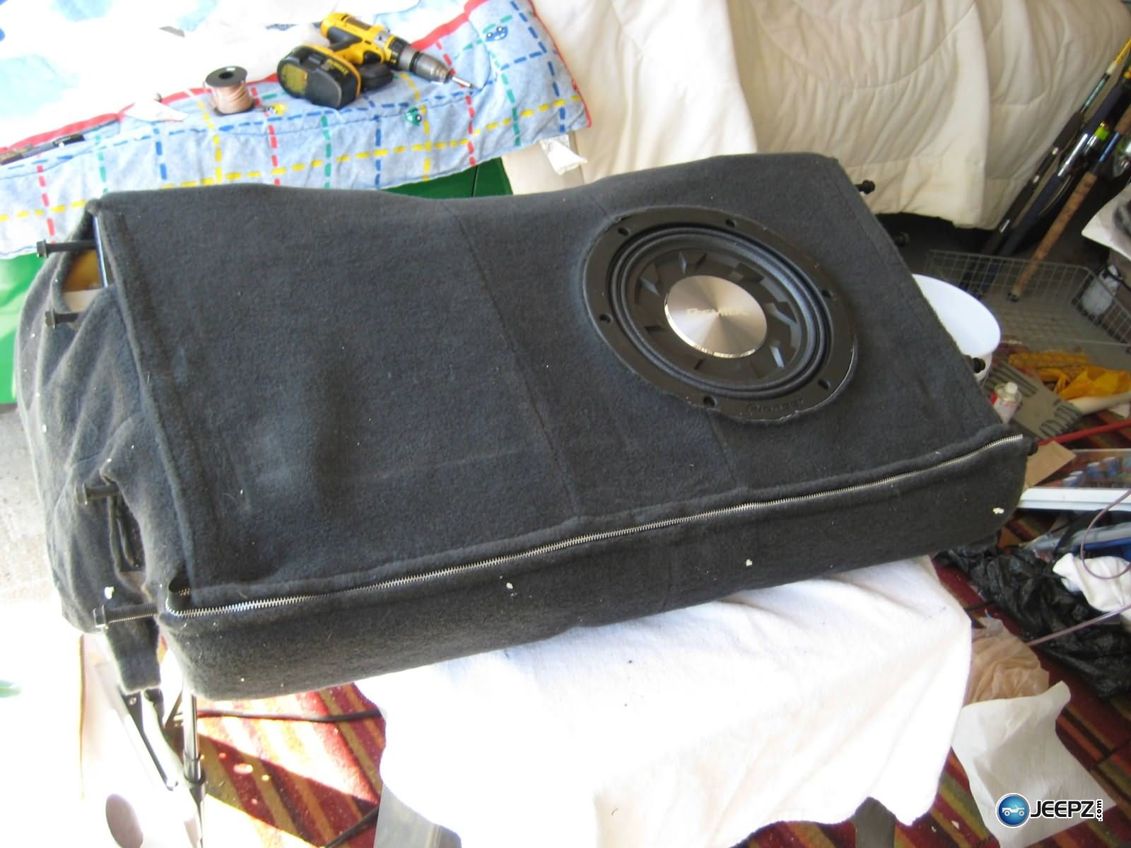

Subwoofer inside of a Jeep Wrangler rear seat
Cut a hole
You really don't want anything making contact with your subwoofer while it's moving, so I cut a hole in the carpet under the jeep seat to accommodate it.

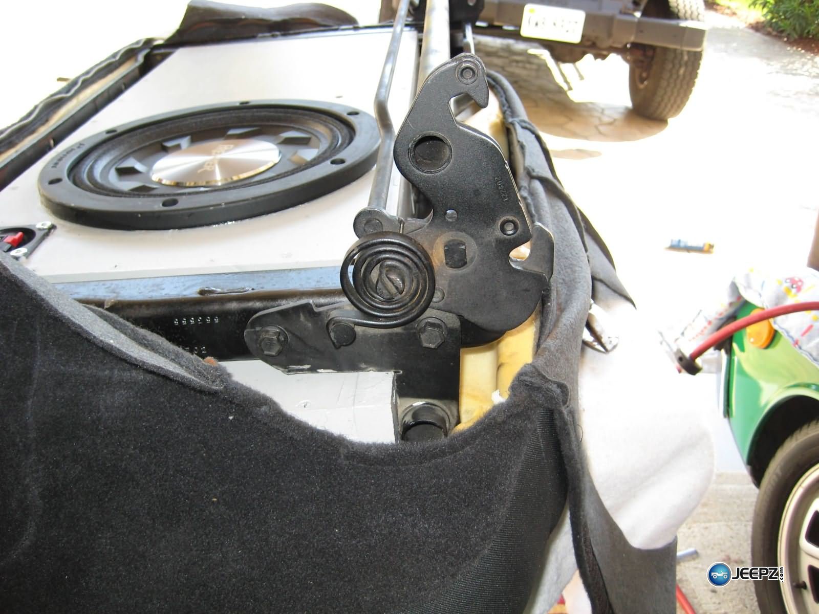

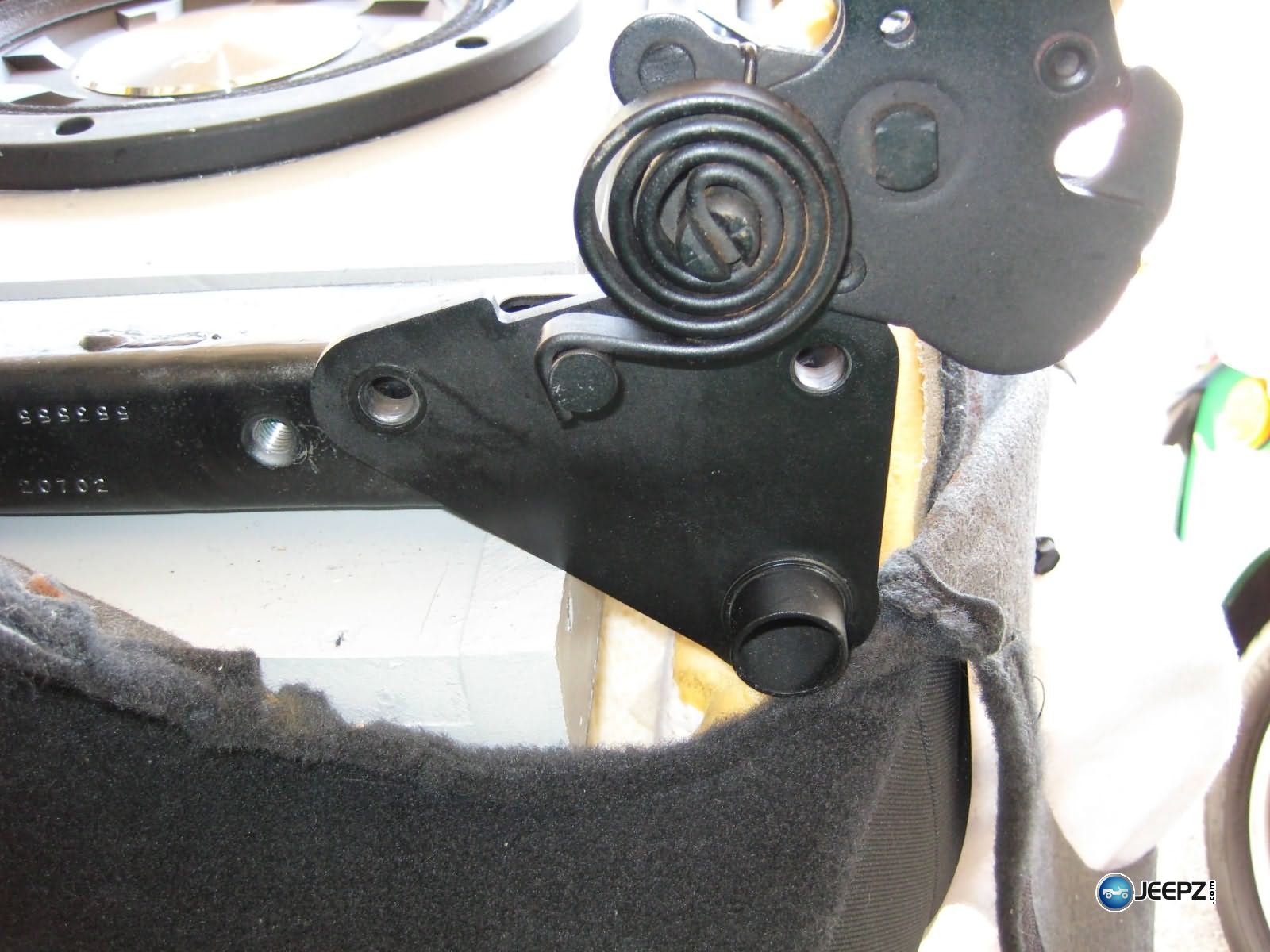

Notching the bar
Now, before you can zip the seat up, you have to use your grinder once again. This time you'll be cutting the bar that attaches the seat to the floor. You can see in the first photo how the new box keeps the bar from attaching correctly. Just cutout the section you see in the second photo.
Finished
That's it! Just take your time and zip the seat back up and you'll be ready to tick off the neighbors and walk around saying "huh? I can't hear you" all day long.
