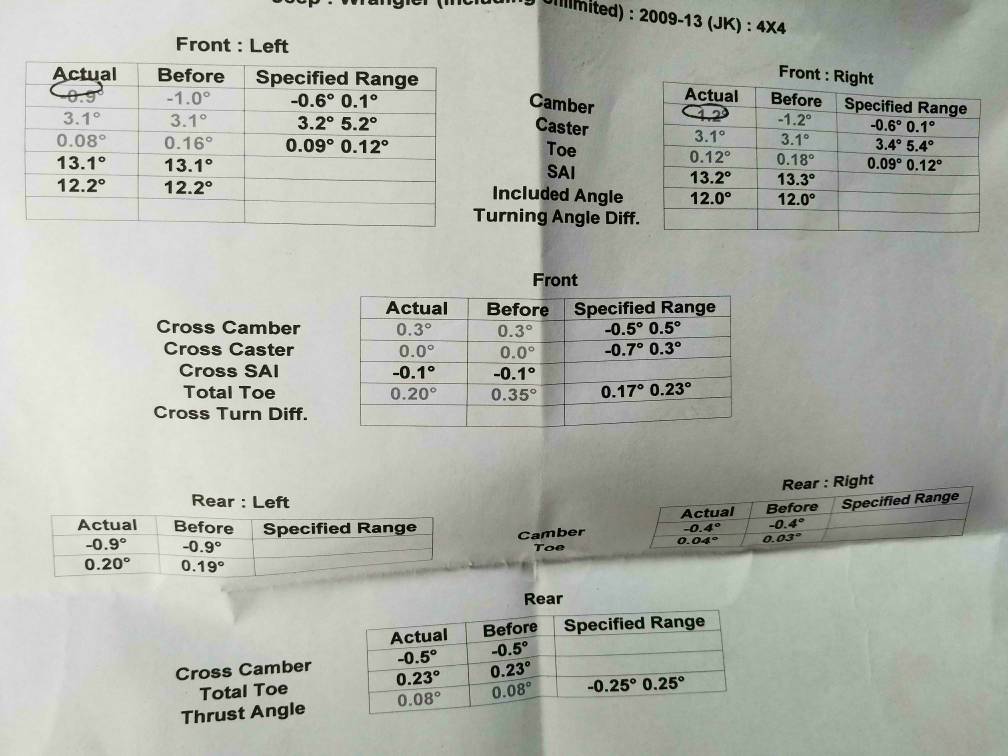

Ok did you go look at my last one that I posted on the other thread?
Sent from my SAMSUNG-SM-G891A using Tapatalk
Here is the paper showing that they gave me after aligning the control arms.
Yah your caster and camber are out. It really should be min 5

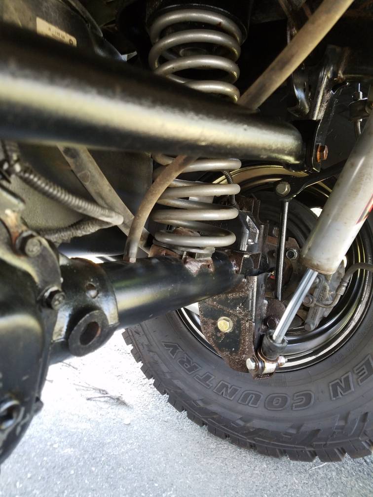

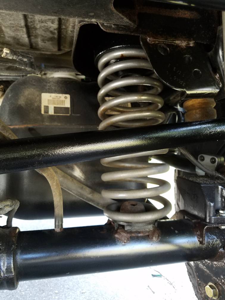

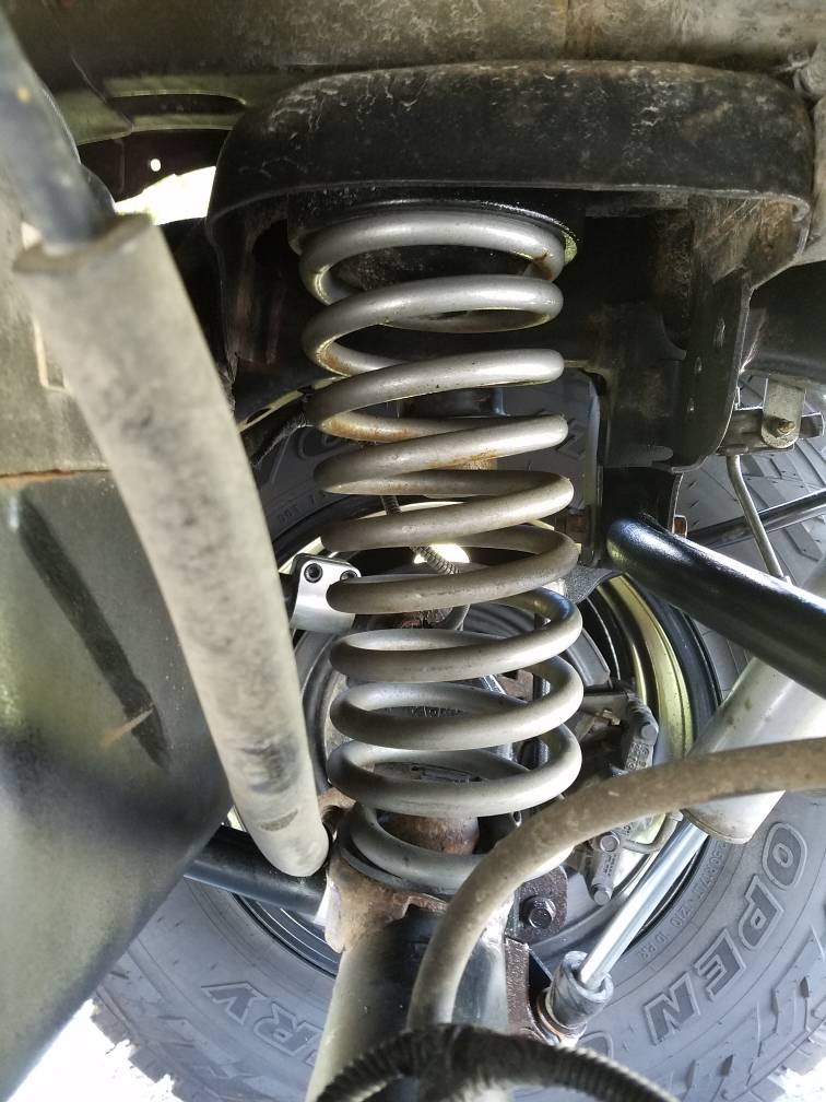

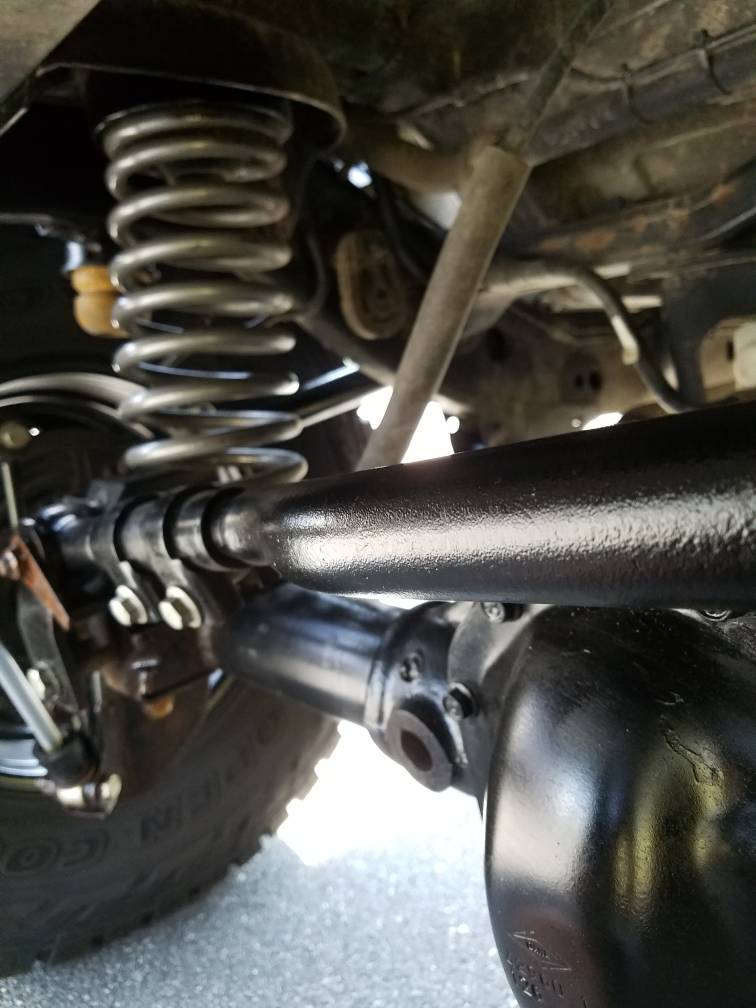

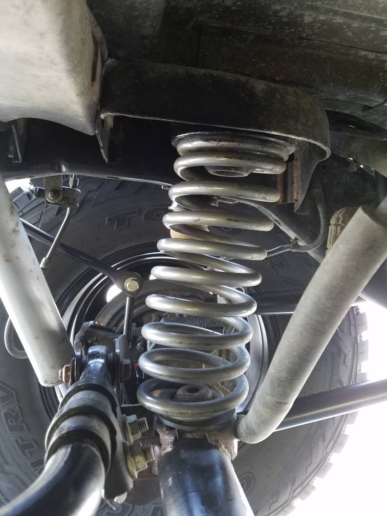

You think this could have something to do with my steering problem? I just looked at my rear axle. Always new it needed to be straightened out but only just realized how bad it is. Idk if it's that easy to see in the picture. But there is a pretty good bend in the spring it almost looks like the spring perch is angles back a little bit.
