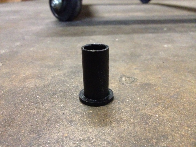

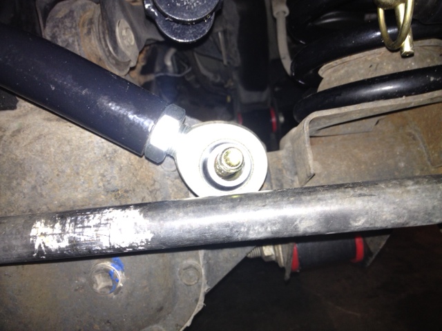

Thanks for the help guys, I think i figured it out. I found that my forward upper track bar bushing bolt hole was about 5/8" where the bolt provided was a 1/2" bolt. I machined a bushing on the lathe to take up all the slack in the track bar. At least I didnt go spend all the money I didnt have to on a steering stabilizer. Thanks again.
