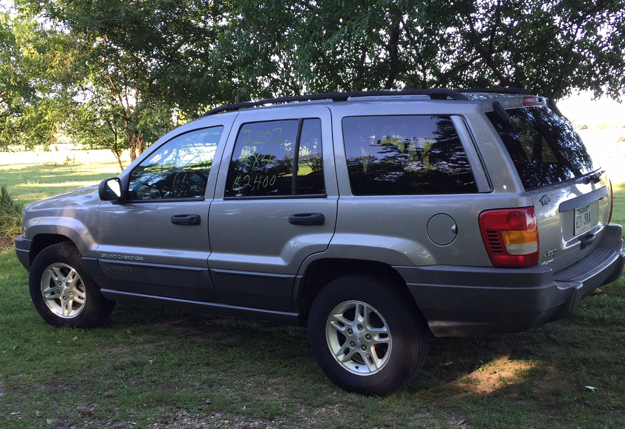

Thanks for the info this is what i am trying to get road ready.... :driving: 2002 Grand(3) copy.jpg
Being you just purchased it make sure the rims are not bent or warped.
As little as mud in the rim will start DW but it happens because parts are loose or worn.
