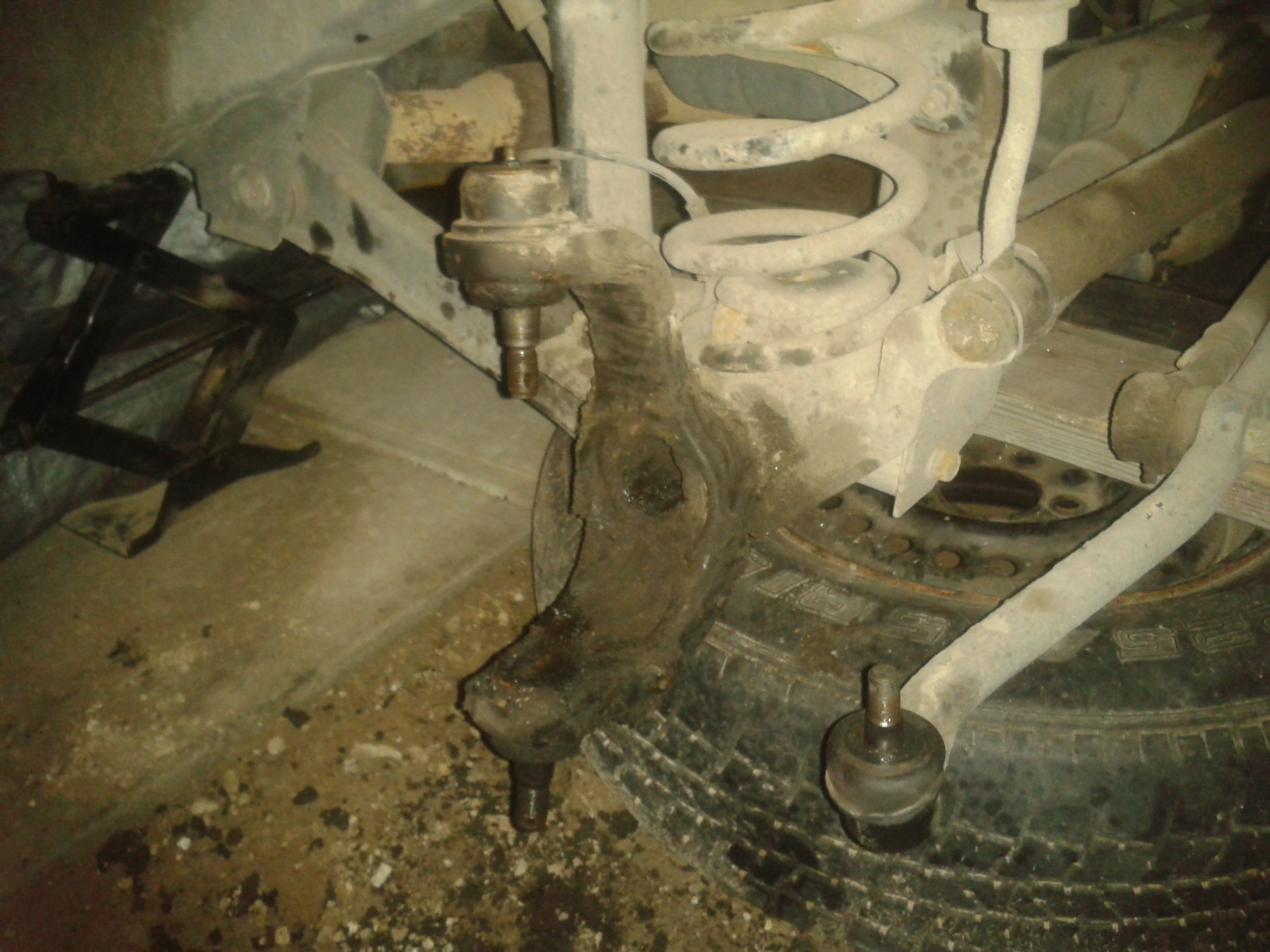

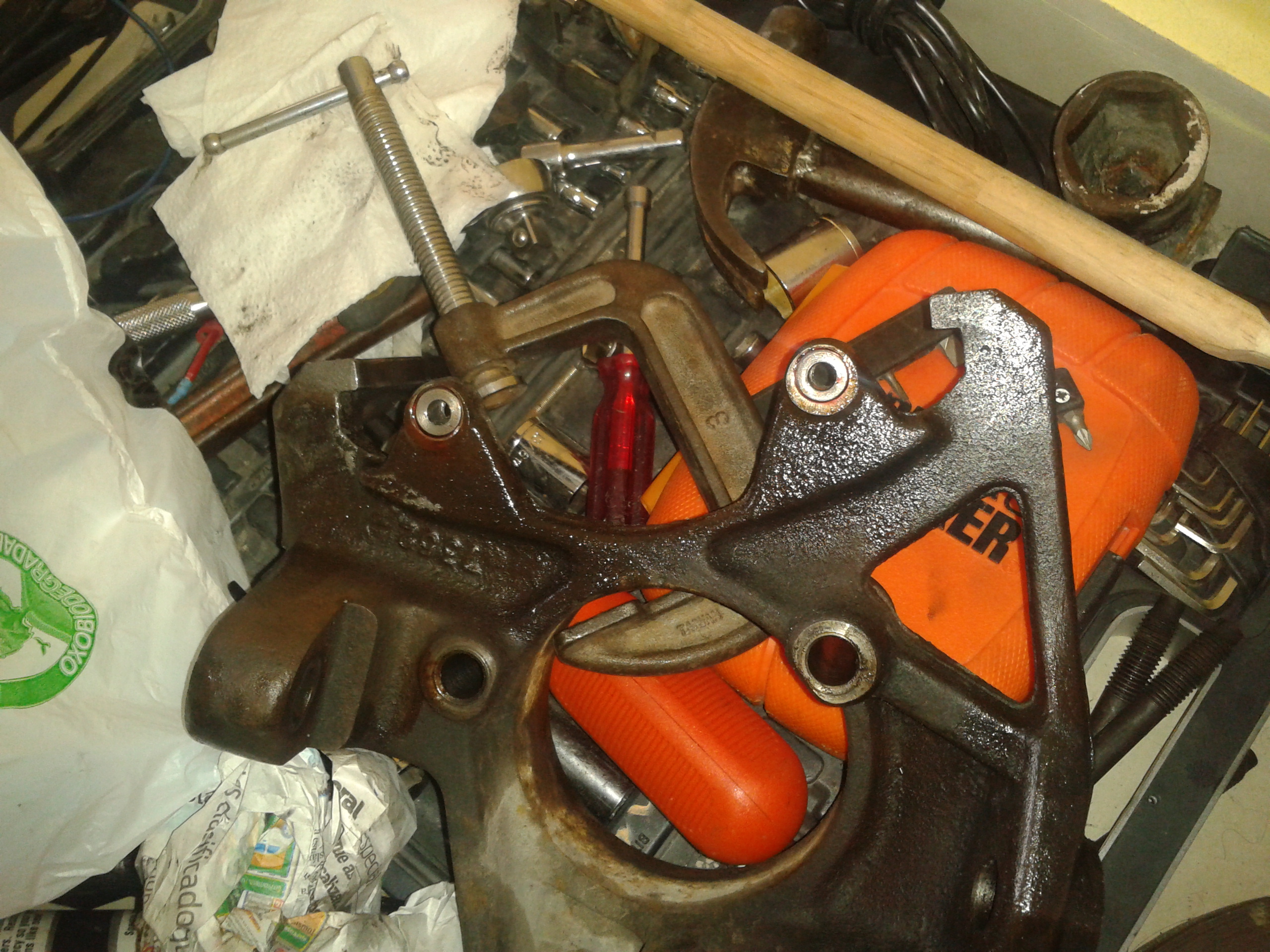

Hi to all... the final thing was inserts. but not the helicoil kind. and since I hade a ripped boot I end it up taking the entire thing of.. but it was fixed. Felt great when I was done
thanks for the help. :)
picture of knockle with "silver colored" inserts on the top side of pic
and where i took it of from.
