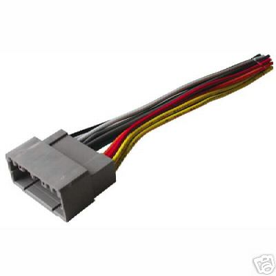

The factory radio is very easy to remove, you just unplug the "wiring harness" from the back of it and it comes right out. Then, to install a new stereo, you go out and buy a wiring harness made for your Jeep, like this one:
Jeep Grand Cherokee 1993-1998 Radio Wiring Harness: eBay Motors (item 330490402333 end time Nov-05-10 11:11:01 PDT)
That looks like this:
This should cost less than $30. You sit the radio on a bench in your workshop and you wire the wires on the back of the new radio to the new wiring harness that you purchased, so when you are done, you've got a new radio with a plug on the back that will just plug into the dash of your Jeep. Not very difficult at all for an experienced electronics installer.
Now, what it sounds like is either the previous owner or the shop you took it to cut the factory harness off. It's not uncommon for people to try and save $30 by cutting off the factory plug, and trying to wire the 20 or so loose wires coming out of the dash directly to your new stereo. I've worked on cars like that, and they are right - it's a nightmare trying to figure out what goes where. I would call and ask them if the factory harness was in place when you brought it in, and if they cut it off - if they did, I would never go back to that shop.
