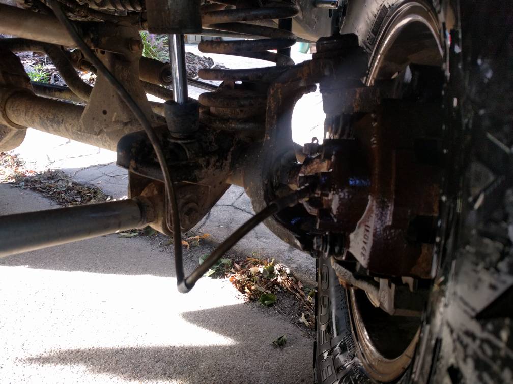

Coming home from work, I was in the right lane when the guy in the left lane one car length ahead decided he wanted to make a right turn. He turned right in front of me, and I stood on the brakes. I knew something was wrong immediately, because while I came to a stop, the pedal went down to the floor. Luckily I didn't hit him. I was only two blocks from home, and drove 5mph using the emergency brake to stop. I later checked it out to see that everything's covered in brake fluid
It may be hard to see from the photo, but it's leaking from the extended brake line.

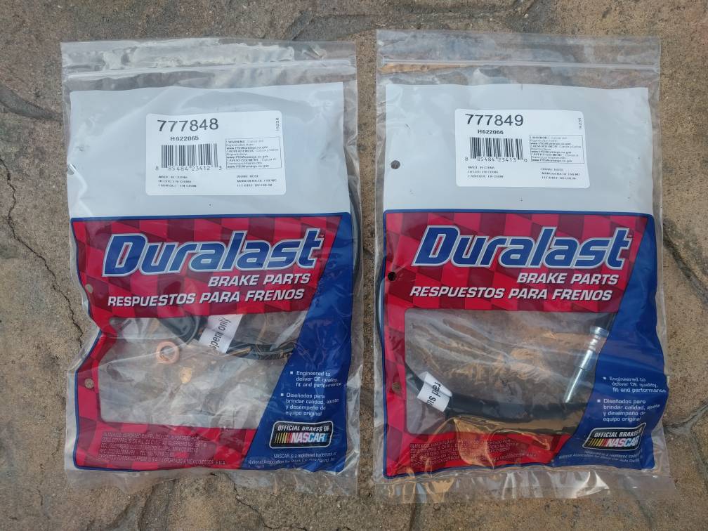

I received the duralast brake lines from AutoZone today. I'm pretty happy with them. I'm not sure if the silver metal portion is coated to prevent rust or not, but time will tell.

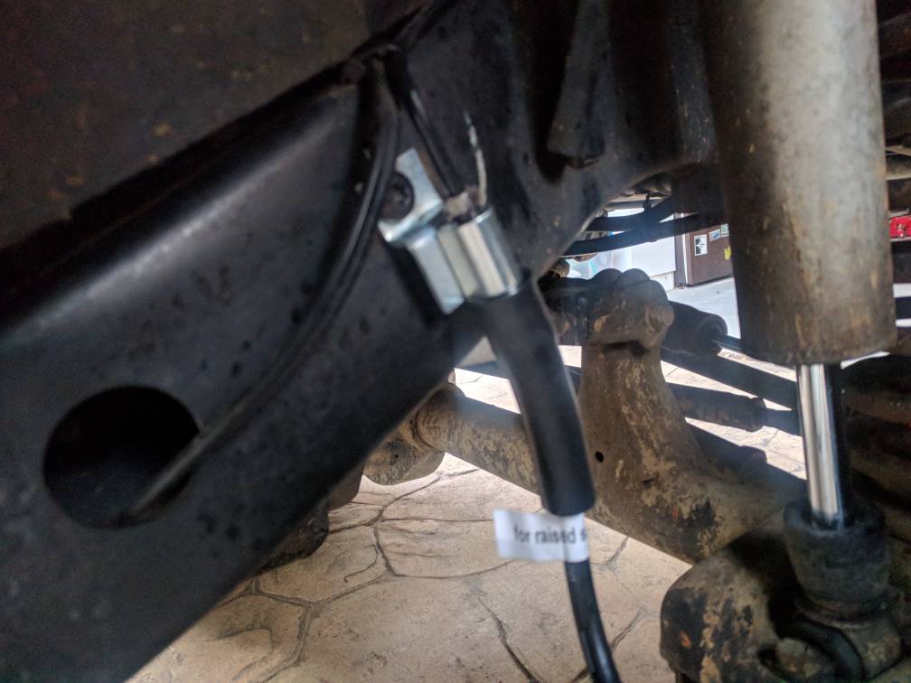

It is about the same length as the crown line it's replacing

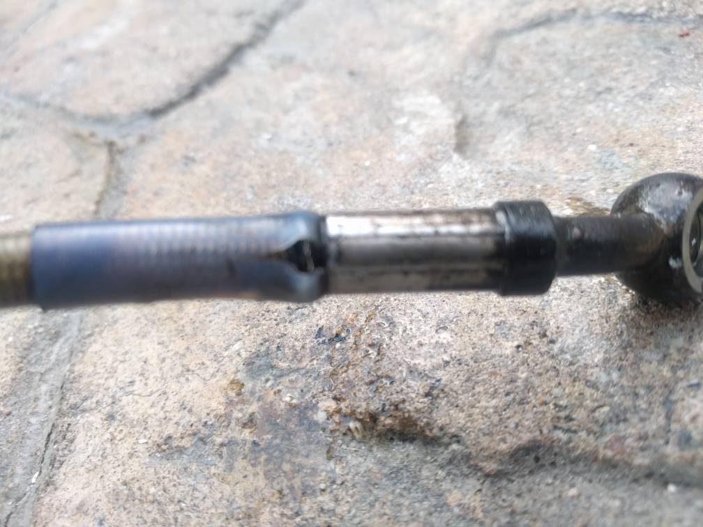

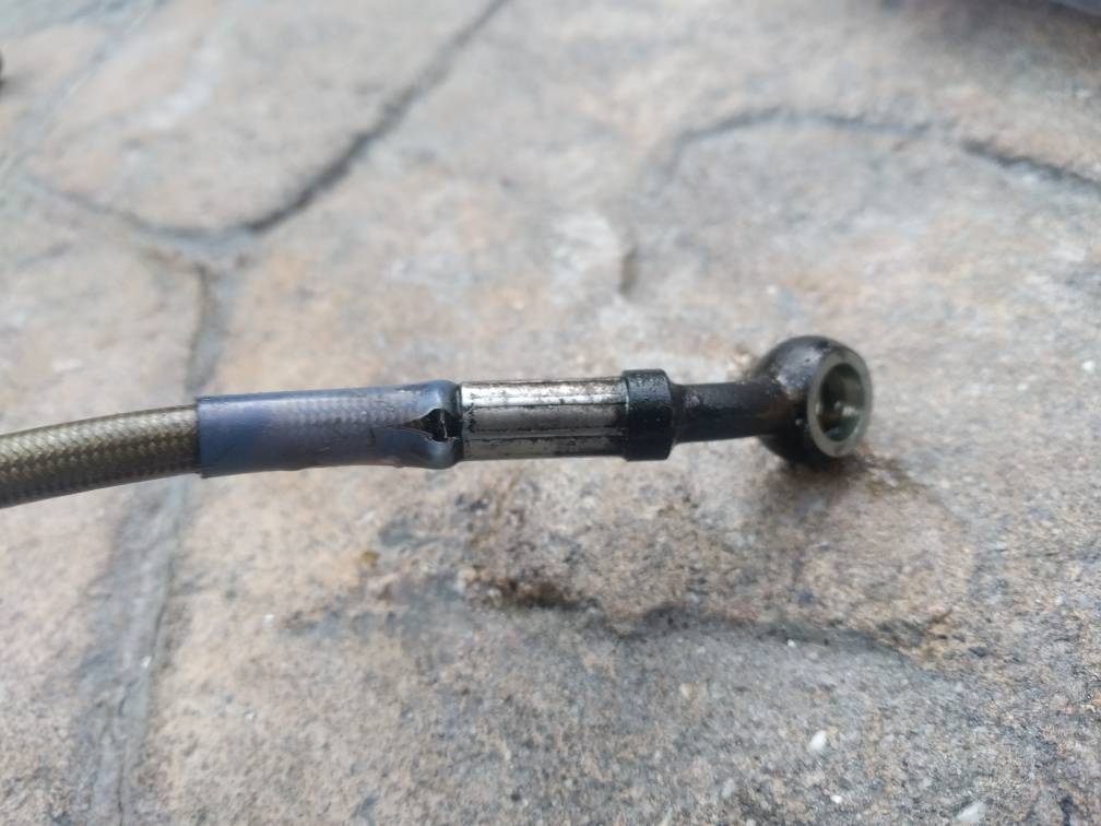

You can see where the old line me burst

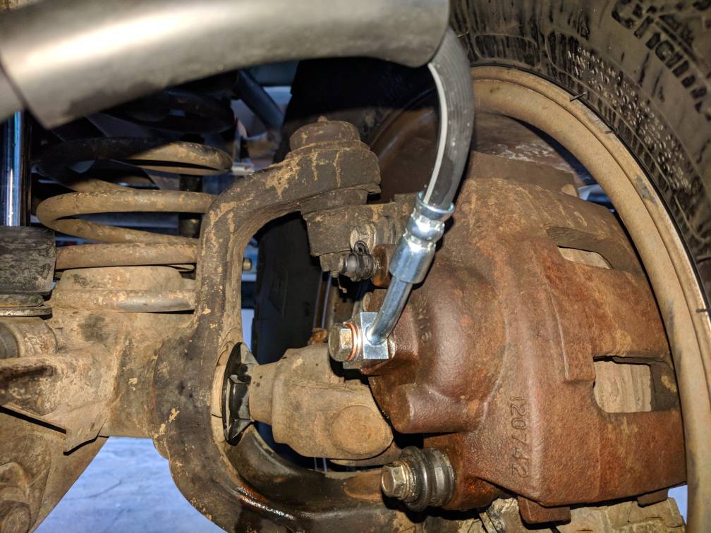

I was able to lock up the brakes after replacing the lines. Hopefully these will last a while
