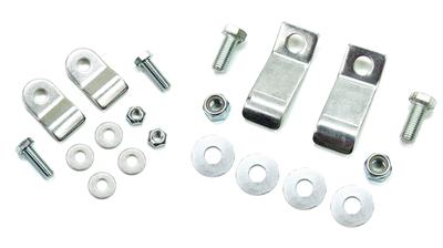

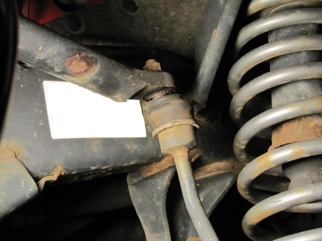

Here is a pic of mine after it broke. Jacked up by frame so tired hang.
Also your springs should limit the axel droop not the shocks. You could break a shock. Springs should be held in by retainer clips. See pic
