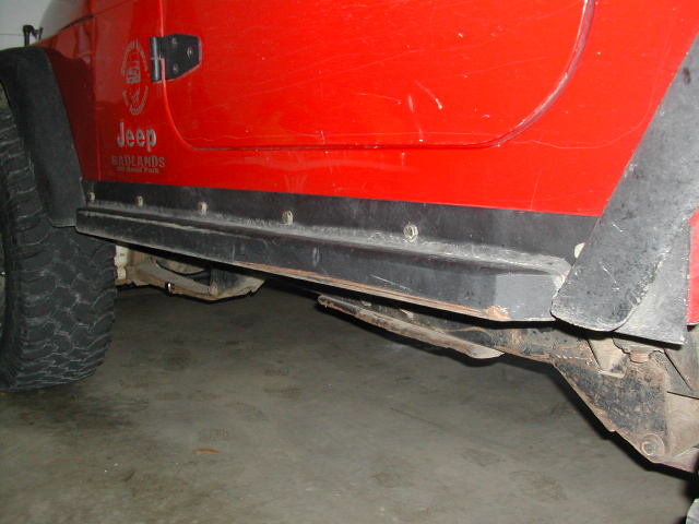

Bumpers are the best! The biggest danger of a High Lift Jack is it slipping and causeing major pain and injury. When I built my last bumper I added these little channel pieces to allow for a slip resistant point or points rather to help in this area. I was going to do the same on the sides when I added sliders but never got that far. Here is a pic of what I mean. tug
Hope that makes some sence. :wink:
Yep. Bumpers are the only choice unless you have rocker panels or rocker skids. Most are beefy enough to handle 50% of the weight of the vehicle.
corey
1/4" steel at the rockers will allow you to use them as a good jacking point. Really helps when you're hung up and need to drive off the jack.
