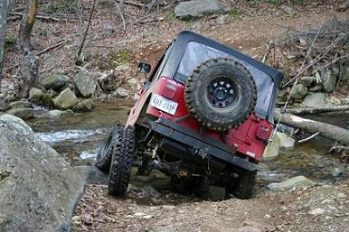

theyre not worth a damn, they screw with your spring rates and you get body roll where sprign flex once was. hers a pic to illustrate. in the picture, his front isnt compressing at all, nor is his rear, all the weight is being transfered away from the springs because the revolvers and z boxes need less force to open than the springs do to compress. they are a flex ramp gimic and not worth while on trails, do it right and go SOA, 1/4 elip, or 4 link and coil overs if you need gobs of flex

I don't think the revolvers are as bad as that post makes them out to be. If you look at that jeep in the picture, without the revolvers, there may have been a lot less body roll but he would've also most likely been riding on three wheels instead of having all four on the ground. When the jeep transfers it's weight and teeters over (like a teeter totter....however you spell it) with the wheel in the air coming down and the opposite tire going up into the air, you would be just as likely to roll if not more likely.
