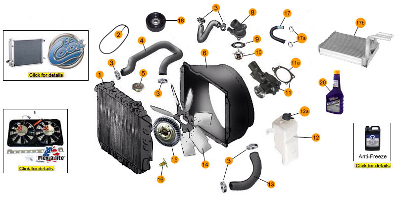

image-4256295982.jpg It is needed. As fluid is heated it expands and pressure builds increasing the boiling point. The radiator cap limits the pressure to 16 psi that in turn limits the boiling point. While a higher boiling point sounds good many components will fail at high pressures. As the fluid pushed past the cap it gets caught in the expansion tank until the engine cools and sucks the coolant back into the system. Without the tank you lose the fluid and gain air in the system. Air allows more internal expansion and boiling to occurs at lower pressures.
