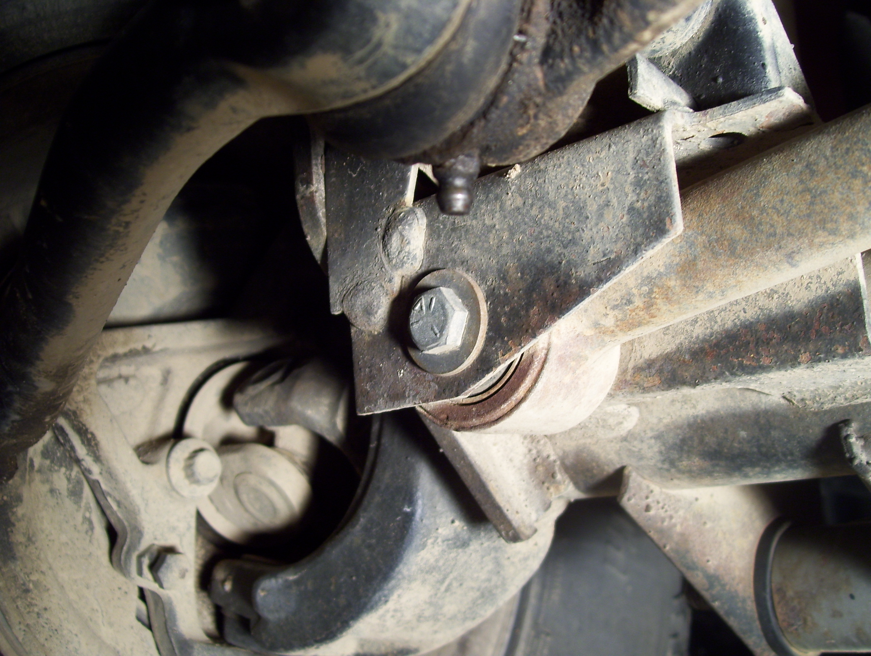

Take a look at the axle end of the front track bar and determine if it has an aftermarket bracket on it to relocate the track bar. Doesn't sound like it since it was 1.2" off during installation. Post a pic of the lower attachment if you have any doubt. I would highly recommend an adjustable track bar.

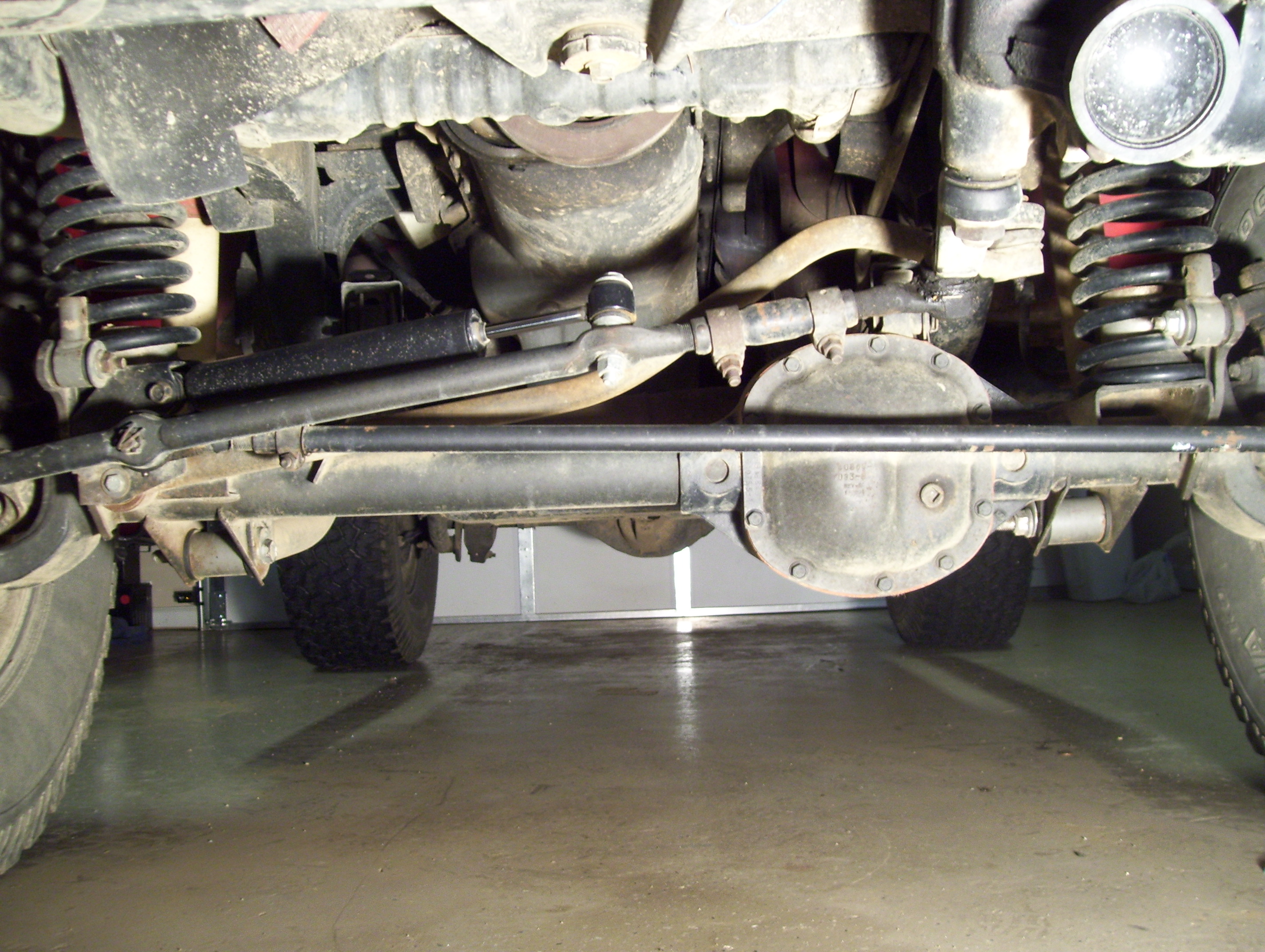

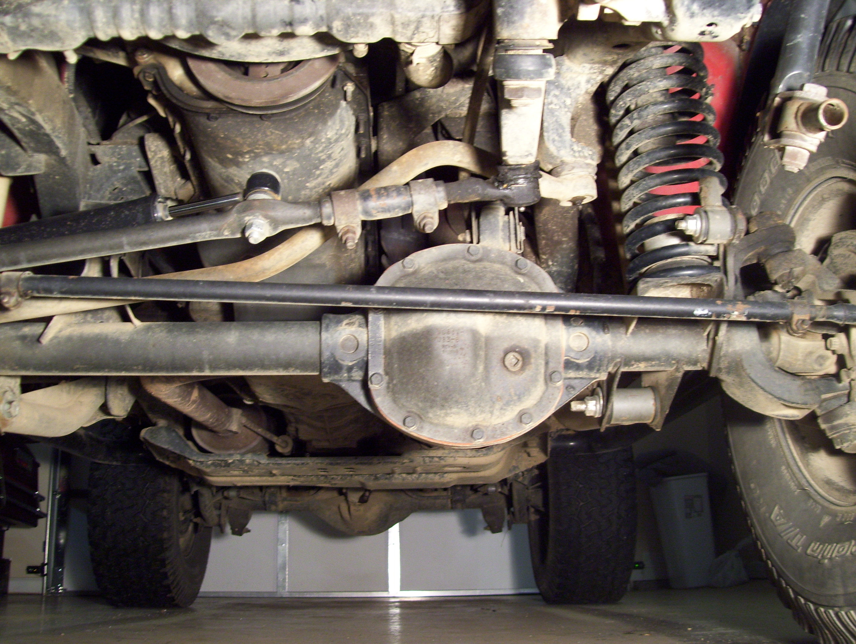

I made a typo on the 1.2, I meant 1/2 so I went back and edited my post. It appears the track bar bracket is stock. I took a picture of it and also the steering setup. tell me what you think.

Looks like everything is good but I'd install an adjustable front track bar if the front axle is not centered. Eyeball each front tire from the front of the jeep, in relation to the flare above it.
Your trackbar and draglink appear parallel so no drop pitman arm is needed.
