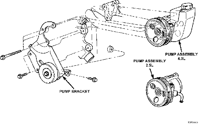

The Web site your looking for is Jeepz.com. Here's a step by step with a Diagram and after intallation procedures and precautions. it's really easy.
POWER STEERING PUMP
REMOVAL
  1. Remove serpentine drive belt, Refer toooling.
  2. Remove pressure and return hoses from pump, and drain pump.
  3. Remove 3 pump mounting bolts through pulley access holes.
  4. Loosen the 3 pump bracket bolts Pump Mounting
  5. Tilt pump downward and remove from engine.
  6. Remove pulley from pump.
INSTALLATION
  1. Install pulley on pump.
  2. Install pump on engine.
  3. Tighten pump bracket bolts to 47 N·m (35 ft. lbs.)
  4. Install 3 pump mounting bolts and tighten to 27 N·m (20 ft. lbs.)
  5. Install the pressure and return hoses on pump.
  6. Install drive belt, Refer toooling.
  7. Add power steering fluid. Refer to Power Steering Pump Initial Operation in this section.
POWER STEERING PUMP - INITIAL OPERATION
[SIZE=+1]WARNING: THE FLUID LEVEL SHOULD BE CHECKED WITH ENGINE OFF TO PREVENT INJURY FROM MOVING COMPONENTS. [/SIZE]
[SIZE=+1]CAUTION: Use MOPAR Power Steering Fluid or equivalent. Do not use automatic transmission fluid and do not overfill. [/SIZE]
Wipe filler cap clean, then check the fluid level. The dipstick should indicate COLD when the fluid is at normal temperature.
  1. Fill the pump fluid reservoir to the proper level and let the fluid settle for at least two (2) minutes.
  2. Start the engine and let run for a few seconds then turn engine off.
  3. Add fluid if necessary. Repeat the above procedure until the fluid level remains constant after running the engine.
  4. Raise the front wheels off the ground.
  5. Slowly turn the steering wheel right and left, lightly contacting the wheel stops at least 20 times.
  6. Check the fluid level add if necessary.
  7. Lower the vehicle, start the engine and turn the steering wheel slowly from lock to lock.
  8. Stop the engine and check the fluid level and refill as required.
  9. If the fluid is extremely foamy or milky looking, allow the vehicle to stand a few minutes and repeat the procedure [SIZE=+1]CAUTION: Do not run a vehicle with foamy fluid for an extended period. This may cause pump damage. [/SIZE]

Don't want to sound like an idiot here but I found this thread in looking at PSC website for installing a power steering cooler, and it says to install on the low pressure line in looking at the above diagram I don't see any lines how do I determine which is the low pressure line?
