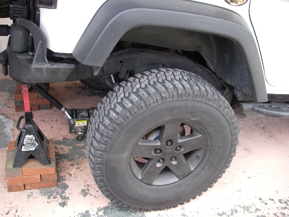

This was a snap to do. I did not even have to remove my tires.
01 Jack up the Jeep and support it from the strong bumper.

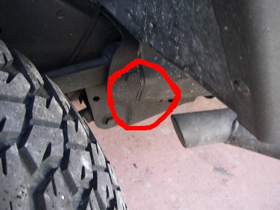

02 This is the piece your going to remove.
03 Use your cut off wheel to remove the piece.
