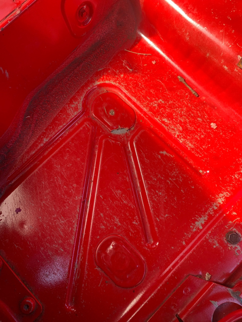

Where is my passenger rear drain plug on my 97 Jeep Wrangler TJ?
Are the coated areas shown drain plugs or there are no drain plugs in the rear of 97 TJ?
Doing a DIY Jeep liner trying to get it right!
Either of those can be popped out. They are metal and can be replaced with rubber grommets.
Look at them from below to remove. It will be easier
Upon zooming in on the lower oblong boss, It appears to me that someone has poprivited a square piece over top of your drain plug and painted over it. . But looking at it for a second time, the grooves in the floor go to the other oblong boss which makes sense that that is where the drain hole is.
