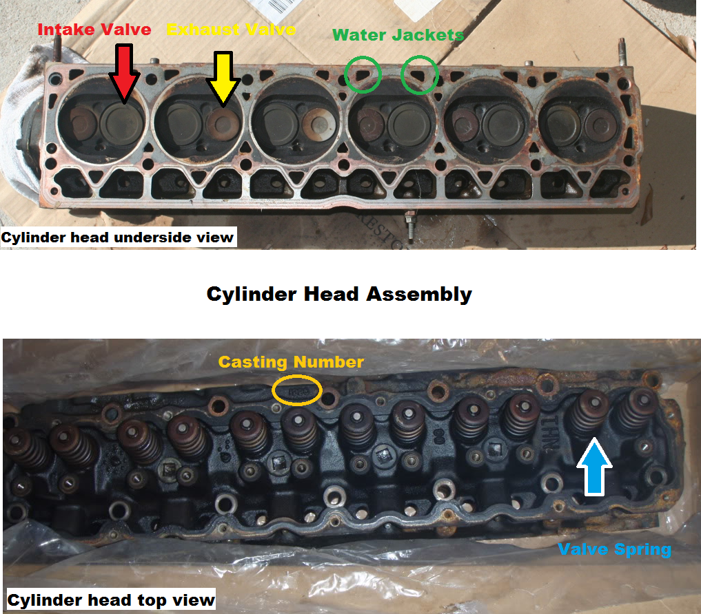

If you warm it with the cap off and see a steady stream of bubbles either the head cracked or the gasket is gone. I'll see if I could post up a thread on checking for a crack. There are certain cast numbers that are prone to cracking.

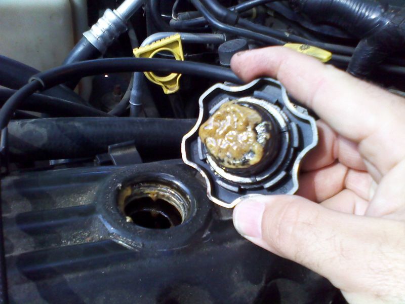

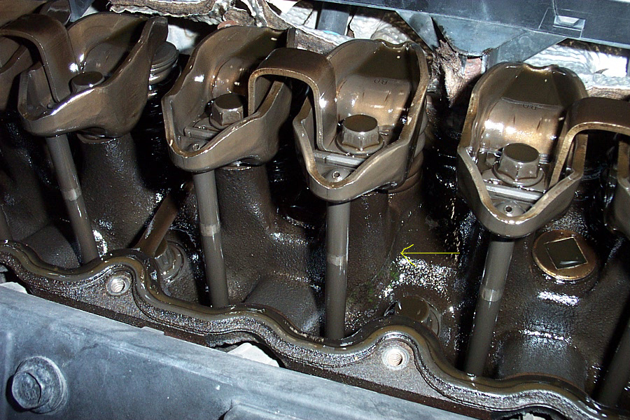

Casting 0331 are prone to cracking. Here are some pics. Water in oil?

Do you have water in your oil? Steam coming out of your exhaust? Smell like burning coolant in exhaust?
