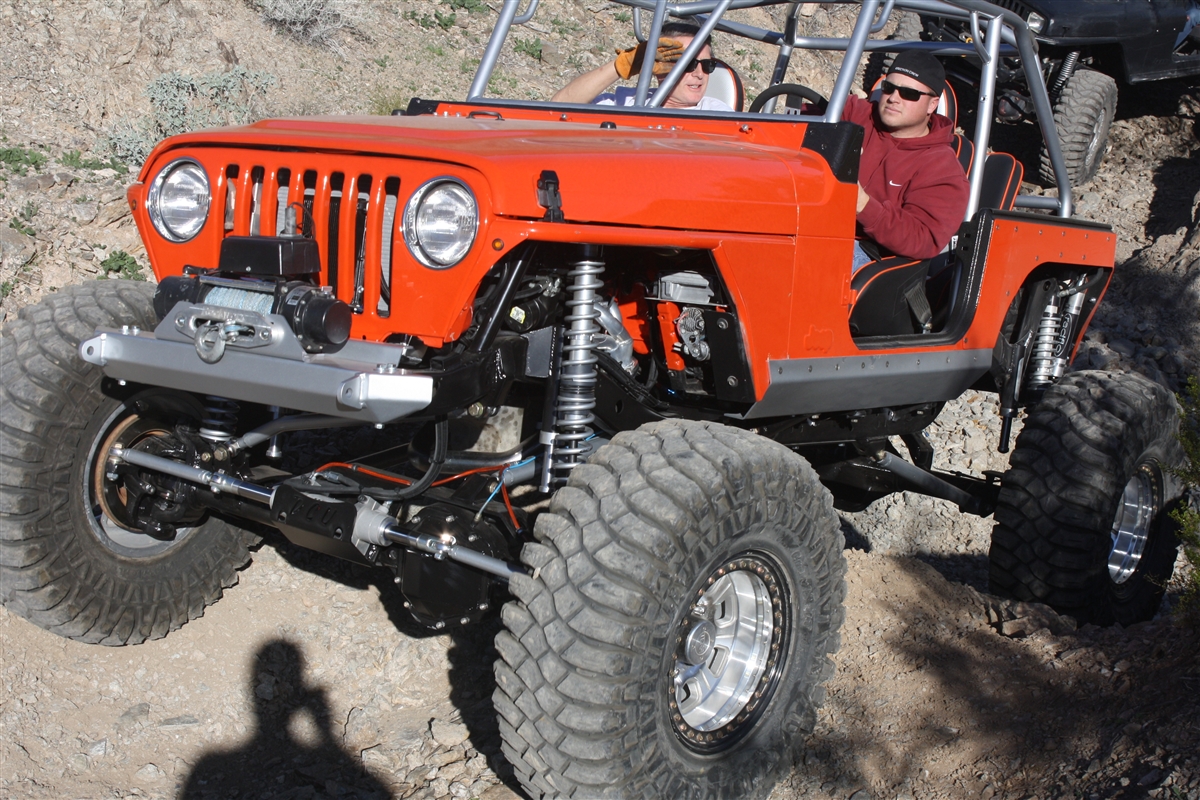

I ordered my boatsides for the TJ!!! I'll have to cut, weld, paint & bolt but I love the look!

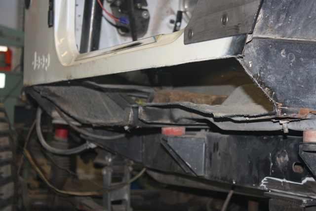

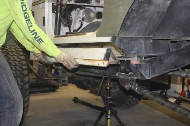

Will do! I'm usually to excited to be modifying the Jeep to take pics but I'll have my buddy on camera duty. My rocker rot started from the inside :-( it's that vibration dampening foam they used to join body pieces together... I'm gonna cut & bed line at the same time too
