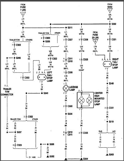

I have a 99 Cherokee sport and my brake lights don't work all other lights work
the connector behind the spare tire has a loose red wire
is it the brake light wire and where does it go???
are all 3 lights inop?
Is there 12v on wire when you depress brake?
Is brake fuse OK?
Is there 12v at brake switch?
What are other wire colors in the connector?
