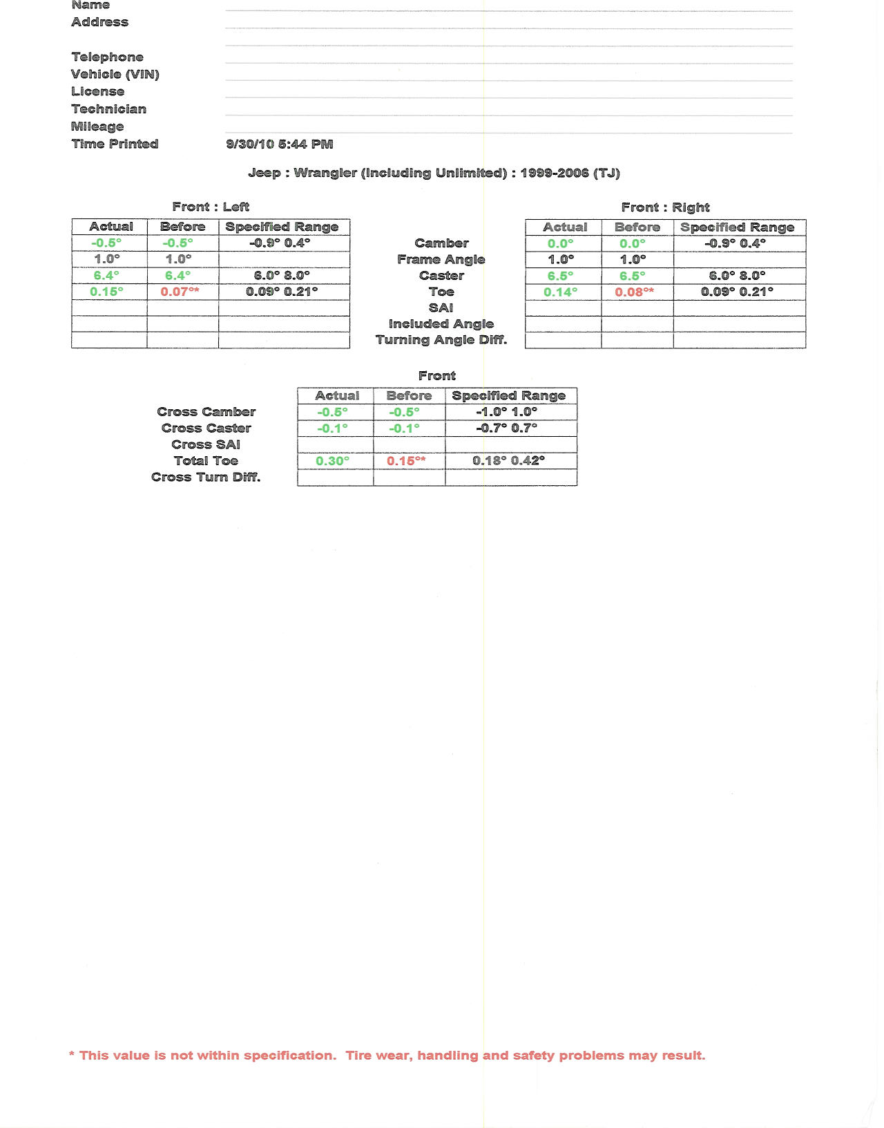

You went with a bigger tire, diameter as well as tread width? Did you have the toe-in checked.
We want this...Toe-In
Not this...Toe-Out

I had it aligned after the new tires were installed. I took it today to have the tires rebalanced, and they found that one of the wheel weights fell off in the 4 miles between the shop and my house :rolleyes: so they added another 3.5 oz the the rear pass wheel.

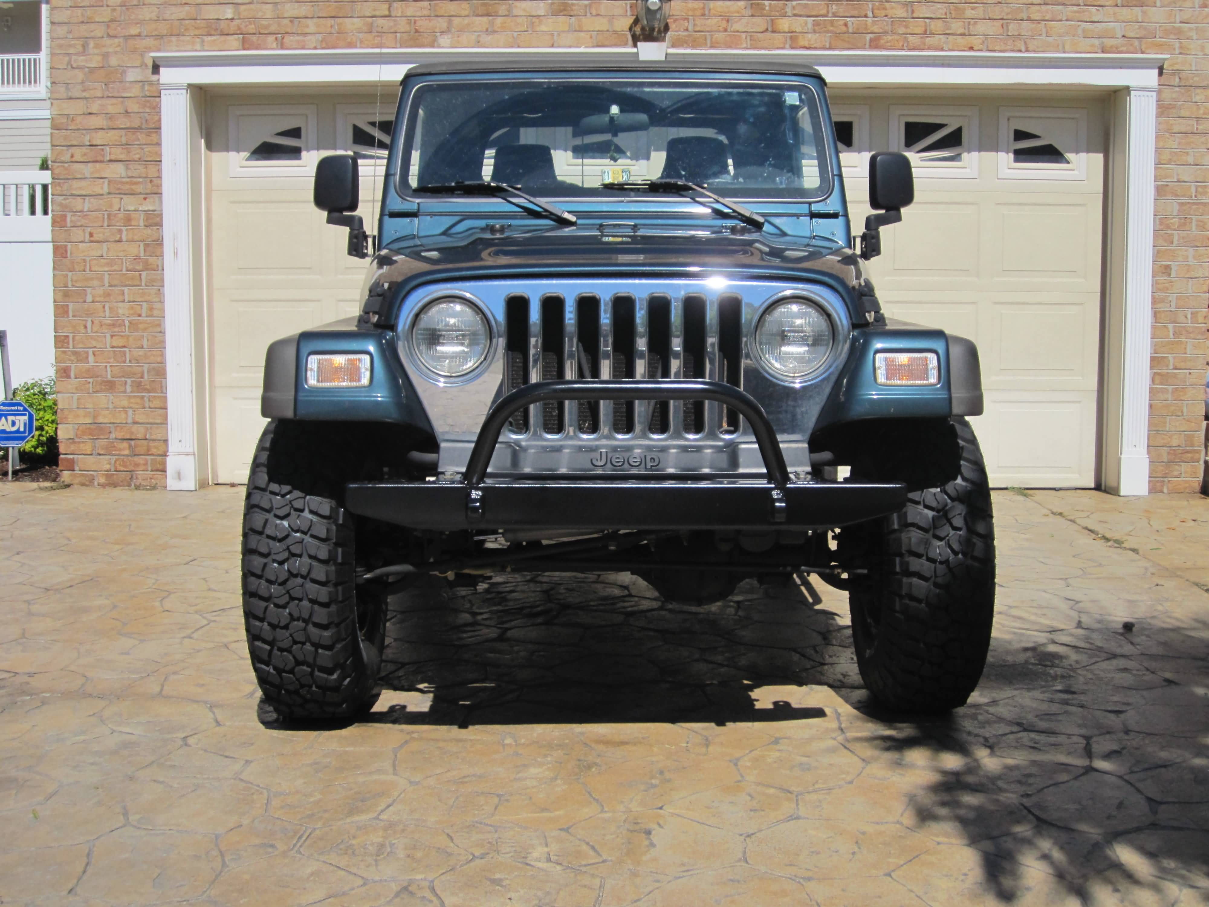

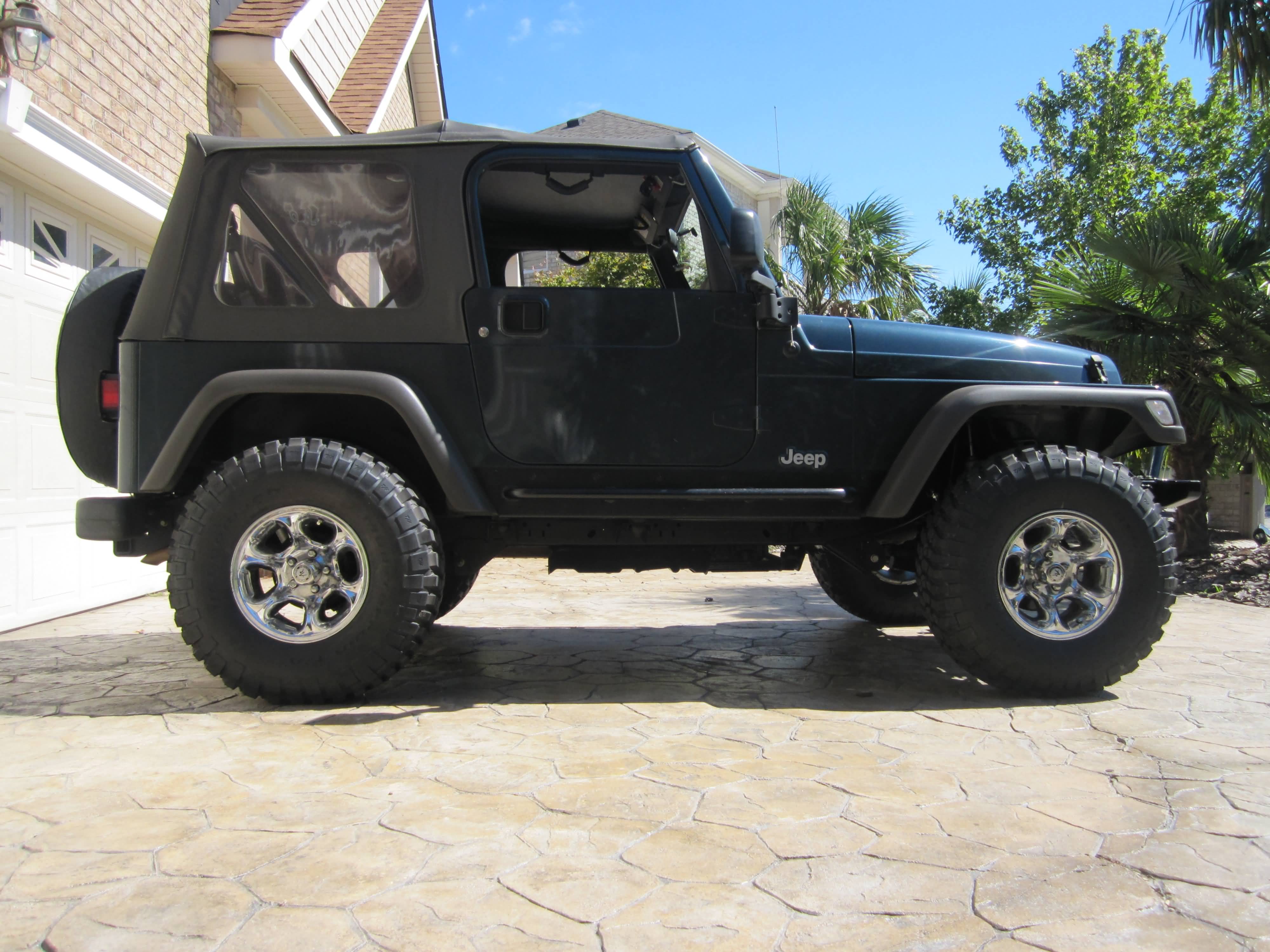

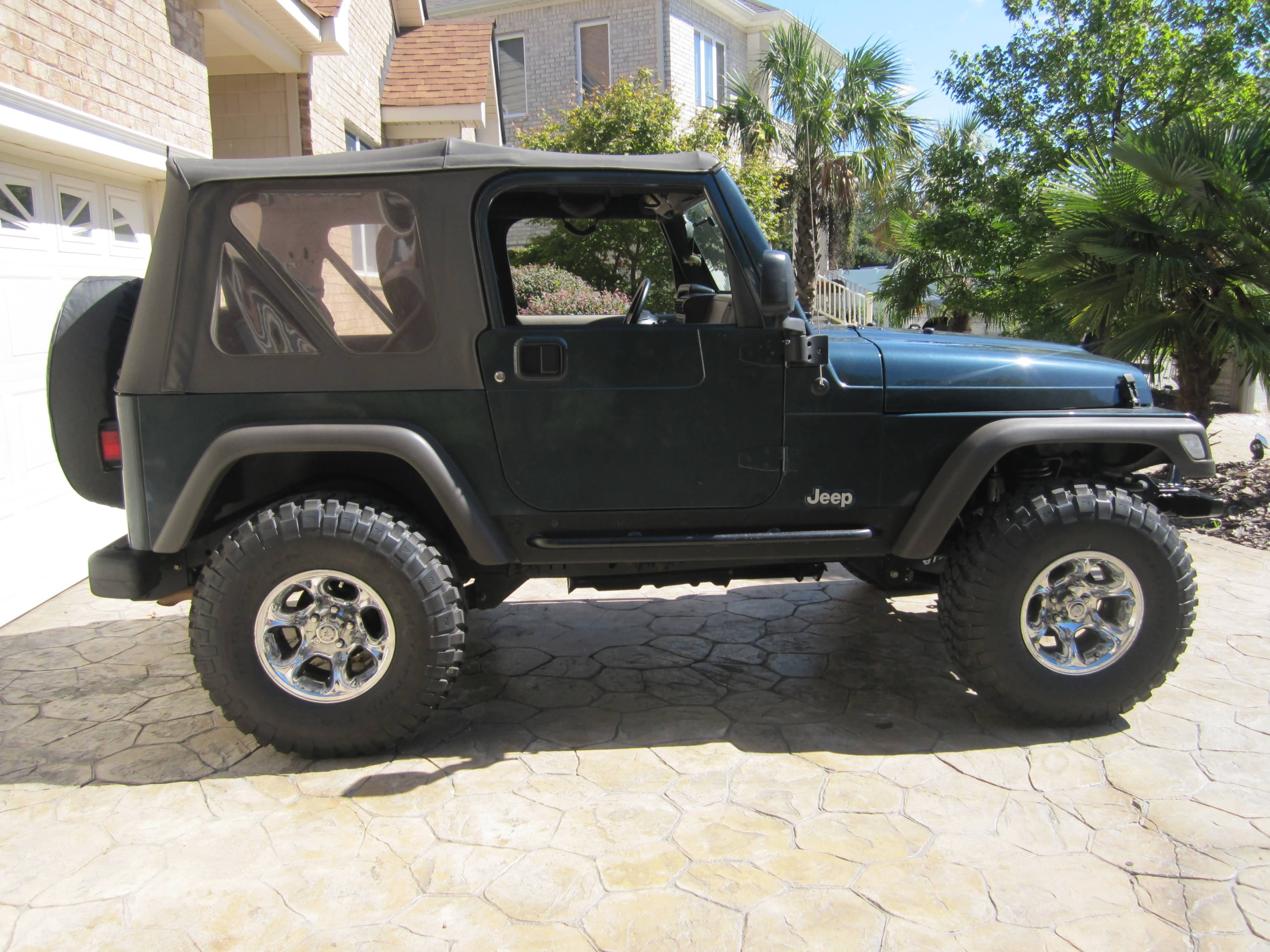

Have you posted any pics of your jeep with the new 33's? I'm still leaning towards a 3" lift with 33's but curious to see how it looks with 2.5.

I'm going for something like this Jeep TJ Suspension Lift. A 2.5" suspension and a 1.25" body lift. I think it will end up just right.
these are BFG KM2 33x10.5 with a 2.5" lift (and no body lift)
