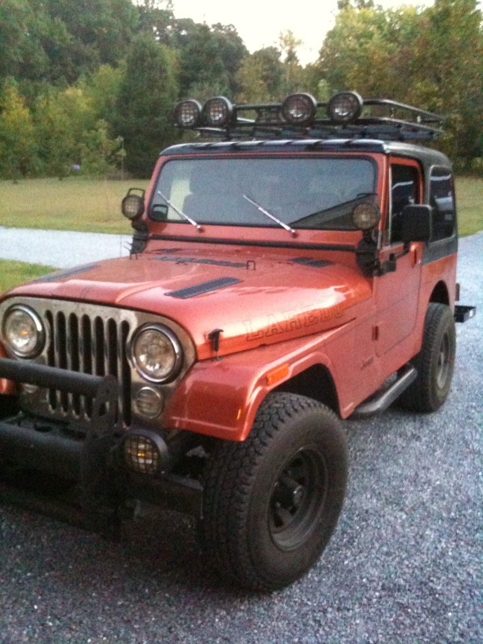

The general thought seems to be I can not fit 33x12.5x15 under a stock 81CJ7 auto w/258. With that being said, I was thinking of putting a new set of leaf springs to achieve a 1 1/2" - 2" lift for clearance. First off, does this sound reasonable?
2) Is there any other suspention parts I need to upgrade/replace (i.e. pitman arm, brake lines, shocks, ect..)
3)Will my stock gears hold up with 33's (not sure what i have because i have no idea what to look for) I know its stock.
It would probably be easier to just put 32's on there but I am a glutten for punishment, besides, 33's look damn good on an old cj.

jps4jeep, thats kinda what I thought. It is a 258 automatic (3 speed I believe) Does that make a difference? When I bought this, my intention was to get it back to stock as much as possible. That idea flew out the window a while ago. I have not been able to put larger tires or a lift due to the fact that I only have 1/2 inch of clearance now to get it in my garage. I am moving next month to a house with a taller garage. (dont tell my wife, but thats why I picked that house. Kinda sick if you think about it. I guess that's why its a JEEP thing.) As far as the other responses, I do not off-road with this. It has to many old rickity parts. Just drive her around town. If you think of anything else I may need to do, by all means let me know. I am not a mechanic, but can find my way around a shop if need be. Thanks again, Bry
