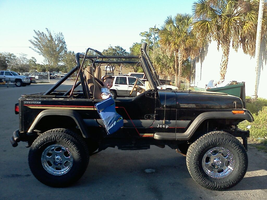

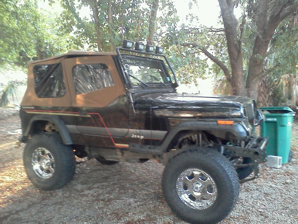

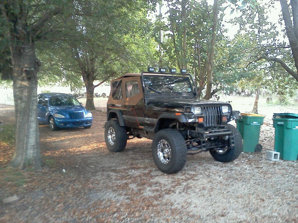

so here is where we stand, not really sure why there is such a gap on the top over the doors...pretty sure the frame for the soft top is going to need to be replaced sometime soon. Now it seems like its going to be nickle and dime stuff from here on out. All the major work is done.

I like the strep down the side, it's original. That keep is really nice looking, I think you guys did a heck of a job.
Can you adjust that bar that lifts the center up to bring the space down some
I havent l ooked at it much today, but I dont think I can adjust it...theres a bar that bolts from that to the windshield. I need to get the top off when it stops raining and get a good look at it. Pretty sure that the frame is too jacked up to really be able to do anything with it and I dont have experience with the soft tops because I never had one for my previous jeep. Its a smittybilt top and it seems like a quality product but it just seems like stuff doesnt line up and it seems like it wants to come out of the channels. Maybe when it stretches into shape I'll be a little happier about it...if not I'll do the bikini top and tonneau cover thing.
thinking about finding a set of full doors for it too...not so sure how comfortable I am with my son in there with the half doors.
Your rear windows look stretched the wrong way too. Bestop is a better option. Just be sure to identify the current HW to match the correct top to. Otherwise buy the top and HW togehter.

You do not have the correct soft top material for your soft top frame.
In the first pic you can clearly see that the frame is an aftermarket bestop system that uses rounded door corners (designed initially to be used with factory hard doors. But in the later photos with the soft top fabric and windows on, that is clearly a factory design soft top fabric with square corner doors. the metal frames between the two are very much dimentionally different.
For example, your 1/2 door uppers are for a stock (style) top with square corner's, but again, I refer to the first pic you can see the rounded corner in the frame. Basically your trying to put a square peg into a triangle hole using a round hammer.
Other than that, it looks like you have a good cruiser there. The shackle angle on the fron looks to be a bit too vertical for my liking. also not a fan of the rims, but that is only my opinion.

Is that your wife's pt in the back ground? If so, that funny because I have a black yj and the wife has an electric blue pt too
It looks like the fabric on teh actual top is also designed for the factory style hardware and not the aftermarket, it might seal better, and fit somewhat better, but will not solve the issue.
It also looks like the rear bows are not extended. I think with a best top and a YJ it is the second hole from the bottom for the rear bows.
as it turns out the hardware is not only broken, its the wrong style for the top as stated in previous posts, so I guess I'll look for some new hardware sooner than later.
the tabs where the back bow is supposed to lock into the front piece are broken off so you have to keep it up with bungee cords, and the drivers side is missing the bar that goes to the windshield. When the jeep came to me there was no top with it so I just assumed that it was o.e style hardware. The vin tag on the half doors matches the vehicle vin so I dont know why the frame around the door would be for a soft top for factory hard doors, I'm pretty sure this came from the factory with the soft top. There were alot of things that really made me scratch my head along the way with this project, but given the way the jeep was treated before I got it, I guess I shouldnt really suprise me that I find things that dont make sense.
